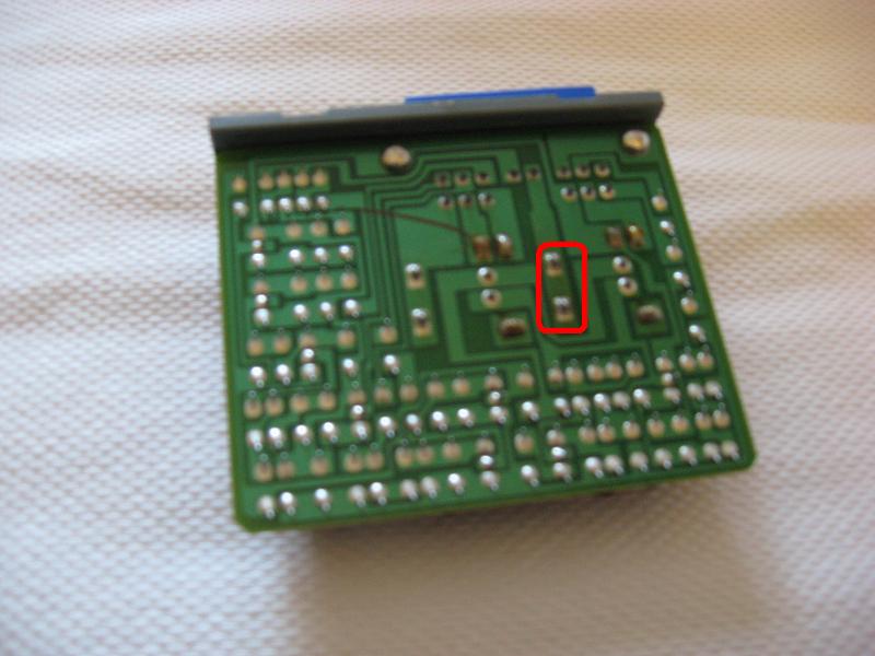

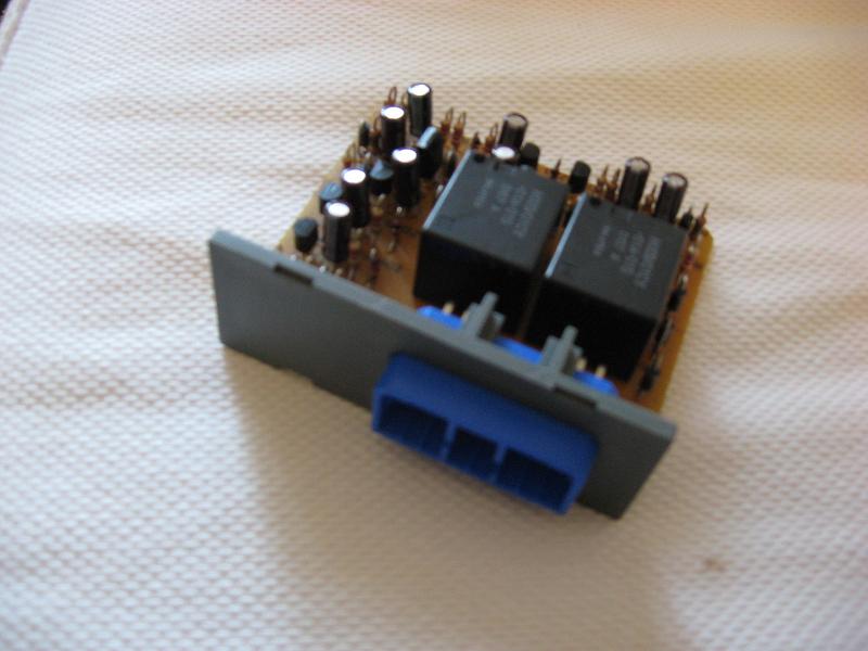

I have had the same problem (2001 Civic LX, right head light DRL) for one year. It got worse in the past couple of months. I just turned on the head lights all the time to get rid of the buzzing. I checked the wiring diagram and suspect the DRL module. I found a clue at wikianswers and took out the DRL module board. Crack solder points found at the relay pins(check the picture). Resoldered them, no more buzzing and the right head light is back in DRL status. This saved me at least $150.
Crack solder points are common when the pins are over heated. I believe this issue is common on this batch of DRL boards. You will see it sooner or later.

Finally someone posted a solution !!!
Those contacts are for the switch terminals of the relay's (must be one for each headlight)
I would solder both relays contacts while you have it apart... and also the smaller leads for the relay coils should be touched up as well.

I have had the same problem with my 2003 Acura (Buzzing, no right head light DRL and no right high beam).
JerryLee and CraigW were right. helpful pics.

Thanks for those pictures, those are the classic poor solder joints for sure. They have the black ring present, easy fix once you know.
You should also do the other relay and the board connector stake pins as well while you have it apart.
