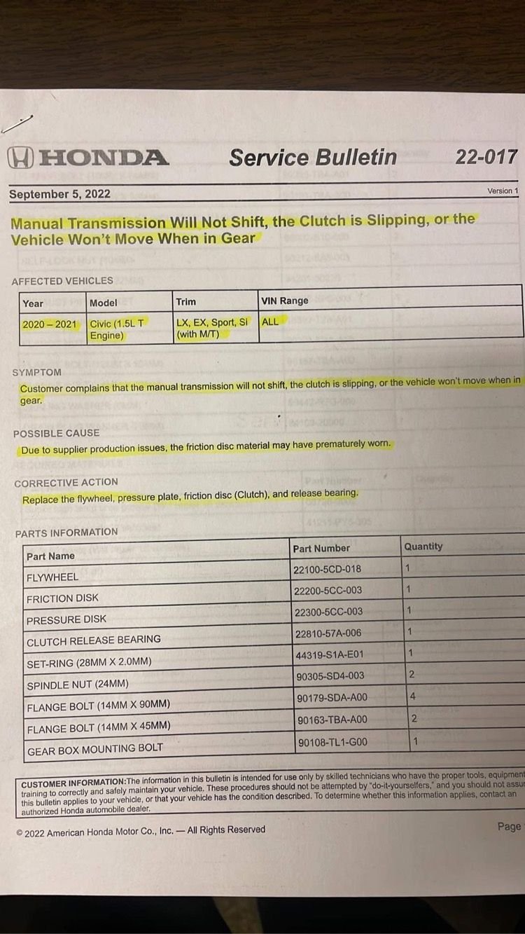

Final update:

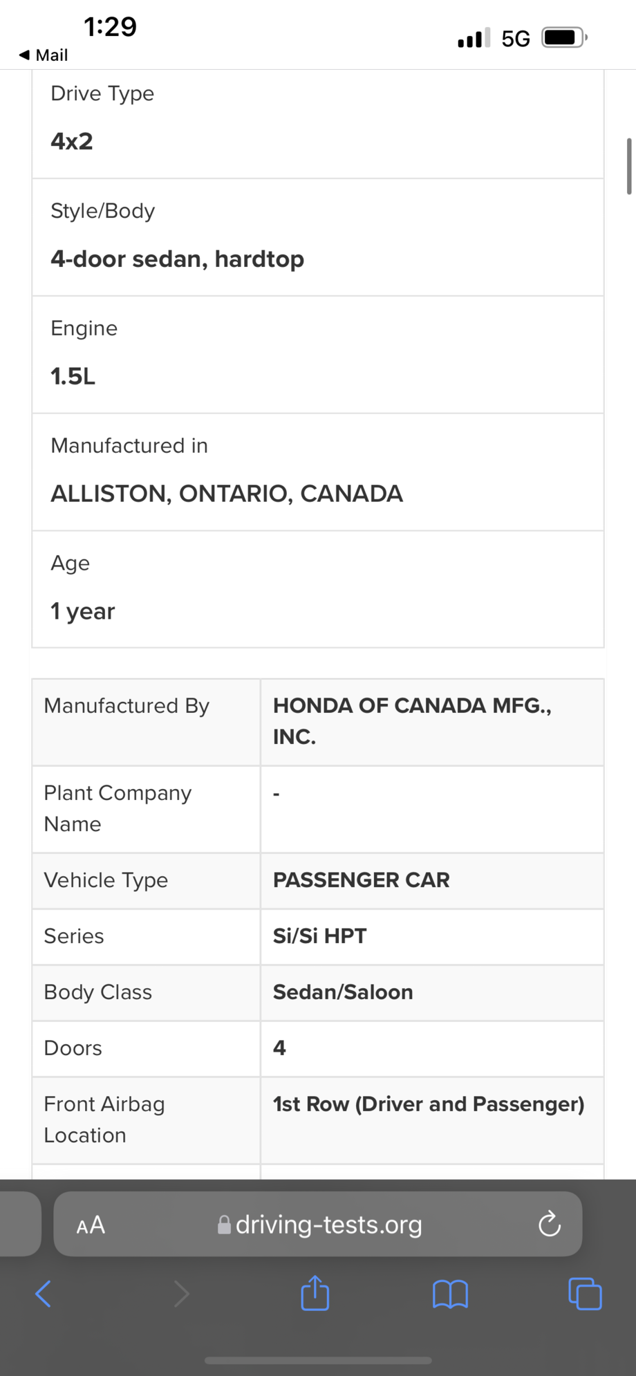

So if you have been following my previous updates, I am a criminal lawyer practicing in Toronto, Ontario, Canada. My knowledge of consumer class action lawsuits is limited so I cannot provide advice in this area of the law. That being said, I can share my experience following my purchase of my 2020 Civic Si vehicle from Honda Downtown in Toronto.
The vehicle was manufactured in Alliston, Ontario. If you want to look up where your vehicle was manufactured, you can put your VIN in this website: https://driving-tests.org/vin-decoder/
One of you who messaged me from the US did this and it showed that his car, despite being purchased from an American dealership, was manufactured at this Canadian facility.
I told you guys I was going through an arbitration process with CAMVAP, and the burden was on me to prove the vehicle had some defect that led to the two clutch burnouts within six months of purchasing the new vehicle. I ended up losing the arbitration as I predicted I probably would because I had no way to prove what defect in the car exactly would case such extreme damage to the clutch in single incidentes, as was the case in my experience. Both times the clutch went out, the entire car filled up with the smell of burnt clutch material and the car's clutch died, signalling that this could not be "wear and tear" but something in the car causing the clutch to burn out randomly.
During my CAMVAP claim, they had an inspector look at the clutch parts from the original car Honda sold me, and then the second set of clutch parts that was taken out of the car when I brought the car to an independent shop to fix the clutch. On the second set of parts, on one side of the pressure plate, ALL of the clutch material had worn out completely, which would explain the extremely strong smell of burnt clutch material that can still be smelled in the car to this day, four months later.
But because the burden was on me to prove a "defect" in the car, and the inspector who inspected my car, which by then had already been worked on by a third party mechanic, I lost the case.
Now, the only way we can come together to convince a lawyer to start a class action is to prove there is a connection between all of our cases.
I would start off by seeing if your vehicle was manufactured in Alliston, Ontario by putting your VIN in here: https://driving-tests.org/vin-decoder/. That way, we know there is a link between our cars and where they were manufactured. Even if your car wasn't manufactured at that plant, it's possible they;re using the same parts or same assembly techniques to cause these failures with the cars
Because I went through CAMVAP and submitted myself to binding arbitration, I do not believe I can be part of the class action, since I gave up those rights by allowing myself to have my legal rights determined by CAMVAP.
However, based on what I do know about class action proceedings, if we can get at least two people with cars manufactured in Alliston, and an expert's report indicating some kind of manufacturer defect that is similar in both cars, then we can have more leverage in convincing a lawyer to take up this case on contingency (they will only get paid if they win).
Because I did not know much about automotive manufacturers and those with the expertise to take a look at my car for defects and get them to write a report for me to tender as evidence at my arbitration hearing, my case was dismissed. So that is what a plaintiff would need in this case first and foremost before a lawyer would agree to take on the case:
1. Connection of similarity of issues between the cases
2. Evidence of the similarity of the issues and that that issue is causing the clutches to fail prematurely.
A class action can be started anywhere. If you are in the US, and I know there are a few of you in the same states, you can get together to pay for an expert to examine your cars and the clutch parts and then approach a lawyer to see if they would take on the case.
But if you guys are checking your VINs and everyone with this issue has had their car manufactured in Alliston, then I can be of more help since I am licensed to practice here and have conections to lawyers here.
If any of you know anyone who works in manufacturing in the automotive business (and I'm not just talking about your average everyday mechanic, but an expert with a cv that can back up his opinion that Honda, through negligence or wilful blindness, caused these cars to go to market with such a defect that would cause premature clutch damage in some of their vehicles with that defect.
I am exhausted and at the end of my ropes. But that is basically the best information I can provide.

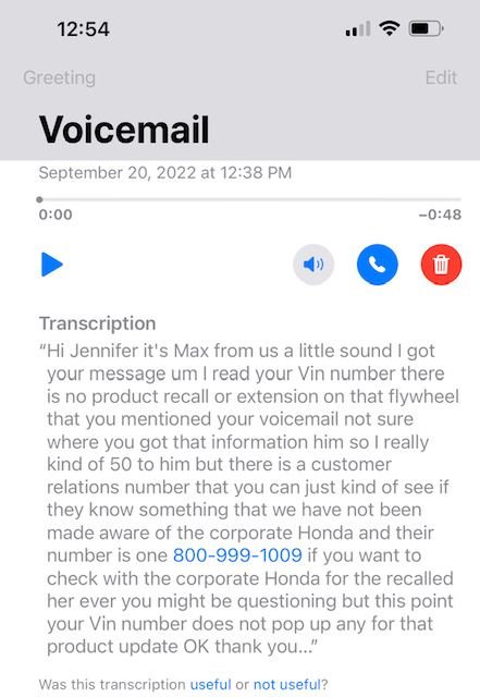

re: 2020 Civic SI Clutch Component Failure [Honda noow taking warranty]
Here are a few short videos of a Honda America rep responses to my phone inquiry asking to rush order the fly wheel for me. That's me sitting in the hospital trying to get my car repaired talking to the rep on speaker phone. I had agreed to pay the full cost off the repair from the start. My problem was that they claimed they didn't have the part in stock until 3 months and my clutch was torn apart at the dealership.

Final update:

In case anyone is still watching this thread…
If you had your 2020 or 2021 Civic clutch replaced while the rest of the drivetrain was still under warranty, you should go back and talk to your dealer.
Honda issued a technical service bulletin on 9/5/2022 that applies to ALL 2020 and 2021 manual transmission Civics, wherein the clutch/flywheel/etc are now covered under the drivetrain warranty because of a production issue.
We have a 2020 Civic Sport, around 24k miles on it. Started to feel the clutch slipping in July, so we took it to our dealer. He confirmed that the clutch was bad, that it’s not covered under warranty because it’s a wear item, and that we might want to drive it for a while until it gets worse. I asked how a clutch with 24k could already fail, and of course he said it must be how we’re driving. My 1997 Civic DX had 160,000 miles on the original clutch, but uh, sure.
It started feeling a lot worse a few weeks ago, so I booked an appointment at my friend’s shop, because I’d much rather give him the business.
He looked at it on 9/12 and confirmed it was bad. He was going to get the parts on 9/13. On Tuesday morning, when he went into whichever system he uses (the same one he had been in the day before), the TSB popped up.
He called me back, told me about it, and then called my dealer to see if they were aware of it. They hadn’t seen it yet, but it came up in their system and they told him to have us call and make an appointment. Then he put my car back together, because he was just about to receive the parts and get working on it.
Called the dealer, set up the appointment, went out to my friend’s place to get the car and drove it to Honda. Had a new clutch by the next afternoon, no charge.
This isn’t a recall, so I can’t imagine that anyone who had previously had this fixed while the rest of the drivetrain was under warranty would have any way of finding out about it. But they should reimburse you if you go back to them and ask about it.

Hi, Thank you for posting this information. I called my dealer and this is the response I got. I called the Honda number listed above and she insisted there was nothing attached to my VIN so there was nothing wrong with my car. I told her it was a technical service bulletin issued 9/5/2022 that applies to ALL 2020 and 2021 manual transmissions. She said that it didn't apply to my car because it would be listed and it isn't. She said i needed to provide her with the TSB number for her to even look into it. That the date it was issued isn't enough. Can you provide the number? Thank you so much for making me aware of this. Jen
