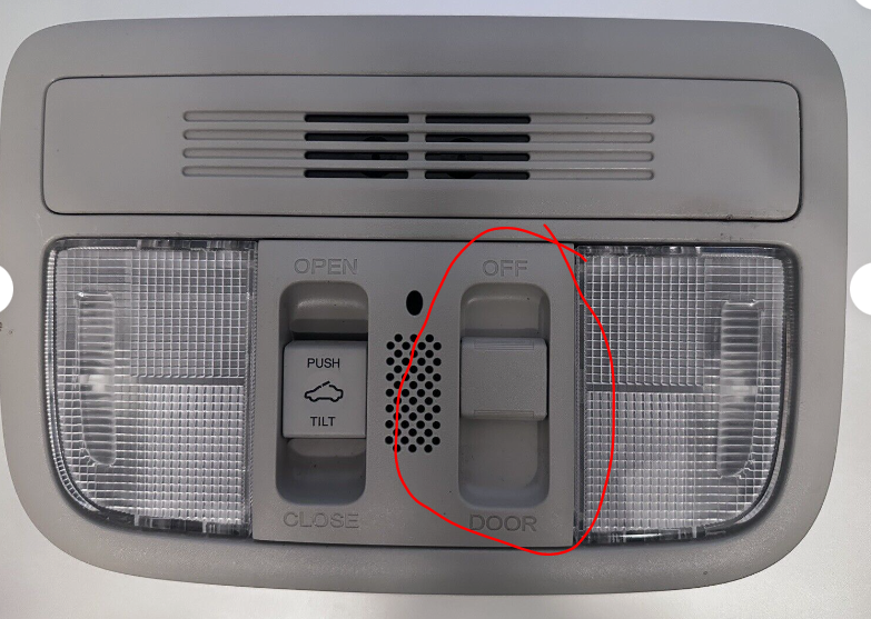

When the door is opened the center dome light, map lights and running lights do not come on. Once inside and the door is closed I can only turn on the map lights. Any ideas? The fuse seems fine.

Checked the switch?

Specifically, this one in the overhead console. If it's set to off, the dome lights will not come on.

I have not and will do that. Thanks!
