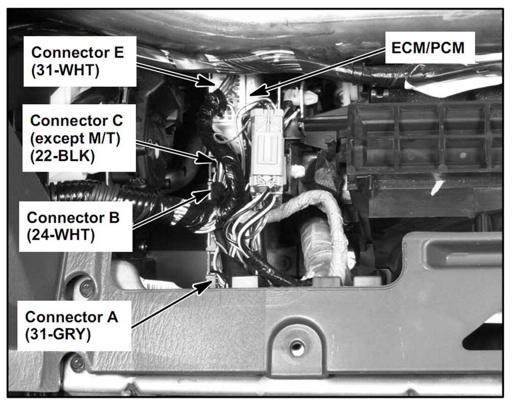

Old Jan 13, 2016
Re: error codes p0141,p0962 and p2770
Goggle image search here
PCM is stuffed in the dash behind the glovebox area. Gotta get the glovebox to open up all the way to the floor so you can see behind it. IDK if you can see the part number easily or not.
It will probably have the part number on a label along one of the edges like this, the top one with PLM in it is the Honda part number on this unit
