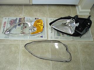

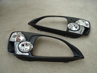

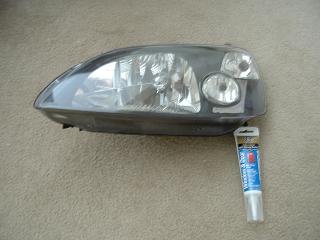

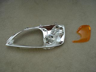

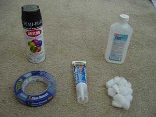

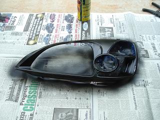

I can post a DIY

here's what i used to reblack my angel eye projectors.
1) adhesive sealant (black stuff. i used this instead because the regular silicone kinda melts when it reaches high temps and comes off..which leads to fogging up)
2) can of spray paint
3) philips flat head to pry open the headlight. and the clips if its oem headlights
4) oven ( most efficient way to melt the oem sealant) or you could use a heat gun or a hair dryer..Dryer case..someone on the board has tried so.....ur call on that.
that's about it. do it right and you're set. hope that helps
