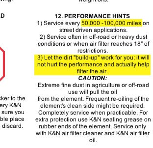

Off the K&N cleaning kit instructions...thought I was going crazy for a second there...

And I just noticed that's in MILES...probably only need to clean the thing once or twice for the whole life of the car...damnn...
