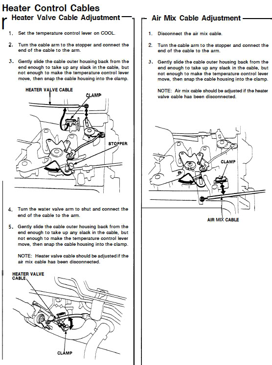

If this is true, that means the evaporator core should be much colder than your 59 degree vent temperature.
Now....how can extra heat be introduced into the air flow within the heater housing?
Recirculation flap not closed, allowing outside air into the car?
Temperature cable mis-adjusted?
Water valve isn't completely closed in the 'cold' position?

[QUOTE=ezone;4719066]Temperature cable mis-adjusted?
As stated the water valve is fairly new and I assume it was adjusted properly.. I texted seller and waiting for reply.

Right. I was looking for cold enough that there isn't any hot water circulating in the heater--- so you can tell if the AC can get much colder than 59*.
I'm thinking if the AC is really working good and your ambient temps are in the 70s or lower, the AC will get good and cold before the engine has had a chance to develop much heat. That could lead to a conclusion of hot water is still circulating in the heater when it shouldn't be (water valve isn't shut off).
Why assume?????

Originally Posted by ezone
I was looking for cold enough that there isn't any hot water circulating in the heater--- so you can tell if the AC can get much colder than 59*. I'm thinking if the AC is really working good and your ambient temps are in the 70s or lower, the AC will get good and cold before the engine has had a chance to develop much heat. That could lead to a conclusion of hot water is still circulating in the heater when it shouldn't be (water valve isn't shut off).
Makes sense.
Why assume?????
Feel the heater hoses. If you've had the engine hot, temp set to cold, and the AC running for a while--- but the heater hoses at the firewall are still screaming hot, that water valve probably isn't fully closed.
Note that engine compartment heat might make the hoses you feel rather warm, but they shouldn't be 180*+ scald your hand hot like the rest of the system.....the supply hose may feel warm but the return hose should not be hot....if that makes sense (it made sense in my head)
Check cable mis-adjustment. Check the cable moves and the arm actually changes positions when you change temperature from cold to hot.
Will report back tomorrow. Superbowl pregame trumps auto inspection at this juncture. I found this for very good a/c read: http://honda-tech.com/forums/tech-mi...oesnt-2900177/
Now I know why you were asking about pressure levels. The mechanic did rev engine a few times while watching pressures as well as during idle. I will ask him tomorrow what the levels were and what lead him to his conclusion of weak compressor and possibilty of contamination.
Attached heater valve adjustment diagram below. Does the HVAC contol unit need to be pulled out of dash to adjust?

Old Feb 5, 2017
Re: HVAC Questions
I dunno...you have the instructions.
What I wanted to find out is whether or not the water valve is truly turning off the water flow.
You shouldn't need instructions on installing the whole kitchen sink just to check if the faucet is dripping. Right?
I dunno...you have the instructions. What I wanted to find out is whether or not the water valve is truly turning off the water flow. You shouldn't need instructions on installing the whole kitchen sink just to check if the faucet is dripping. Right?
I've read (various forums) some people thought their heater valve adjustment was correct, water shutting off but, temps were similar (60 F) at vent to mine. However, after re-adjusting according to service manual they got better readings.
Just spoke to mechanic and said high side readings during idle were inconsistent (needle jumping) and leads him to believe compressor may be contaminated/failing.
Old Feb 7, 2017
Re: HVAC Questions
Ok.... I only wanted to make sure the hot water flow to the core is shut off.
Disconnect the cable from the water valve and move the lever with your finger? If it makes a difference THEN go through all the adjustment procedures (installing the entire sink LOL)
Vise-grips pinching the hose could accomplish the same goal of stopping water flow, but probably cause damage to the rubber hoses.
Hold RPM steady at 2000 for testing. Most compressors don't pump very efficiently when the engine is only idling.
Also....needle issue........if the high side service port is located close to the compressor it can show vibrations on the gauge needle especially at idle, it can sense every pulse as the compressor pumps at low speed.
If the service port were located 'after' the condensor in the system , you would not be able to see as much of the rapid needle fluctuation.
Will do. Plan to work on it tomorrow.
Check out the water valve and see that it shuts off the flow of hot water through the heater core.
Replaced right rear hub and it pulled off in one piece. Seems to be in good shape but, figured best to replace both rear hubs at the same time.
Tightened a/c belt..no more squeal but, didn't get a chance to drive it much afterwards. The short distances I drove the compressor cycled on properly.
I didn't get a chance to mess with the heater valve. I do think it may not be adjusted as best as as it could be. If, it turns out it the heater valve isn't the issue then what may be the next suspect?
