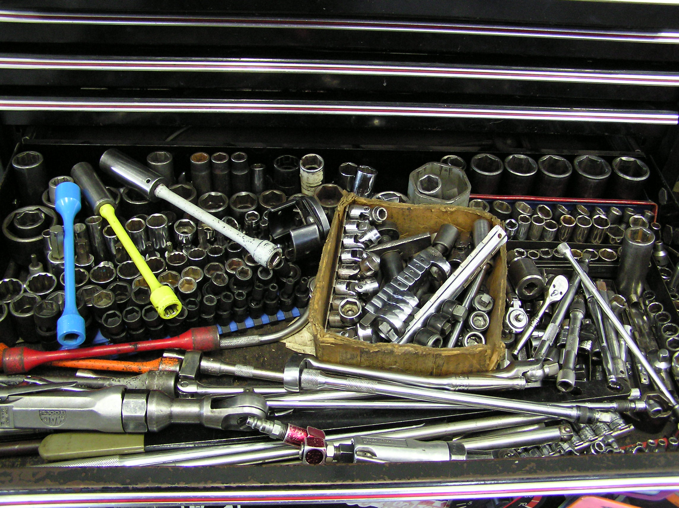

For laughs, here's just ONE drawer from my toolbox (before splitting up socket stuff into two different toolboxes and organizing a little better)
