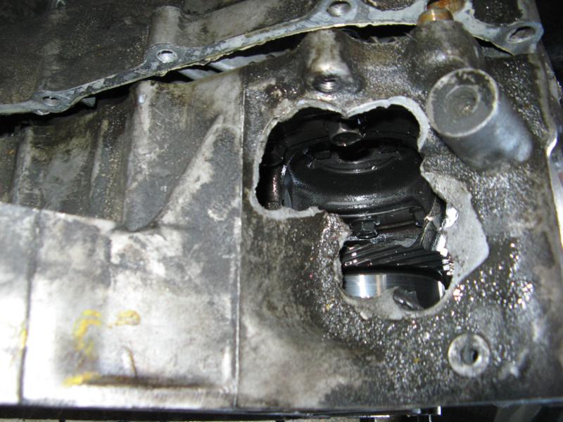

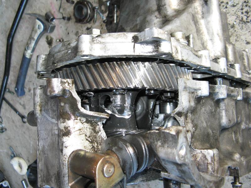

for anyone interested in the case of the exploded tranny, here's an update.
The tranny he got is, in fact, a YS1, that had about 30-40k miles on it. Also, we think the problem was a catastrophic failure of the differential. I'll post pictures of the hole and stuff when I get home from work. I'm holding one of the differential pinion gears in my hand, with the teeth all eaten up and wondering how exactly the shaft sheared like it did. Pics to come later.. lol

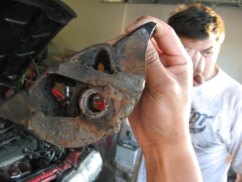

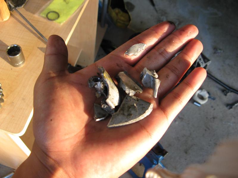

For anyone that's been looking forward to pictures of the exploded tranny, here ya go
Lookie! Tranny insides! My buddy tried to pull the tranny casing apart but couldn't, but you can still see the part of the housing that cracked.
going 180 on the casing, here's a hole that was blown through the casing
lovely motor mount fix the previous owner did
pieces of tranny casing in my hand
