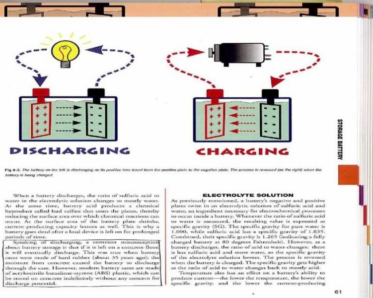

Originally Posted by christmaspie
You're not referring to a modern, sealed lead-acid battery, are you??
Actually yes... I've had it happen to me before a couple of times.
It also happened twice to a friend of mine.
The following is from 'How to Diagnose and Repair Automotive Electrical Systems' by Tracy Martin. I realize it's not the best scan but we're limited to 100Kb. If anyone wants a .pdf I have one, it's more clear but about 500Kb.

Well now that I think about it, the batteries that my friend had were from older model cars, but I don't believe it only happens to batteries manufactured 35+ years ago because the two vehicles my friend had were an '87 ford truck and an '85 chevrolet truck. He had laid both of the batteries out on the driveway while he was overhauling the engines and both batteries were discharged. (This happened two seperate times with the ford first)( A year later he bought the '85 chevrolet and did the same thing.) These batteries were both manufactured, at most, 25 years ago. Plus I did have it happen to me to two batteries that were from the nineties. All the other batteries that I had it happened to, were in fact older ones so you did prove me wrong there.
