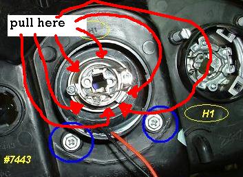

you can pop that socket back onto the ball at the end of screw by pulling where the headlight bulb goes (take the bulb out of course so you dont damage it). it's a small opening on the back of the headlight housing, so find a tab or edge and with 2 fingers pinch & pull
aim the part to sort of rest the socket onto the ball and pull until it pops in. no taking apart the housing needed.
