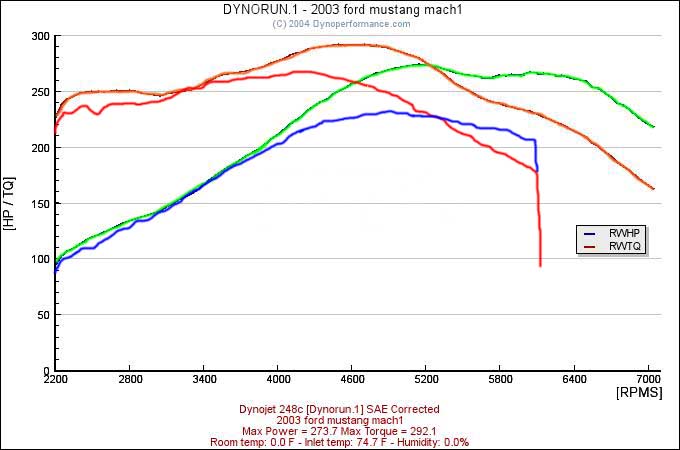

They use fewwer valves becasue they are trying to create more torque to move the heavy **** SUV's and trucks. The 2 valve (or sometimes 3 valve) desgn is used to keep air velocity up at low RPMs, hence you get more power at low RPMs, but suffer greatly at your top end.
The same can be accomplished with a 4 valve head and you don't lose the top end
Heres a comparision of a 2001 Mustang GT and a 2003 Mach 1, the GT has a 2 valve head while the Mach 1 has the 4 valve head
As you can see in the lower RPMs they make the same torque, while in the upper RPMs the Mach 1 not only makes alot more horsepower but also continues to make torque.

True you can do it, but what kind of SUV/truck needs high end hp without torque? In both figures, the torque drops off quickly after 4,500-5,000 RPMs. Without that torque you are not going to be able to push that 5,000 lb SUV/truck down the road. In fatc the ZR-1 vette is even better example than the Mach 1. But those are sports cars, not SUV/Trucks.
I have the 3V 5.4L in my F-150, and I can tell you, while that engine can rev to 6,500 RPMs, after 5500, it's worthless in my 5,600 lb truck. In a large vehicle, no torque=no go, so why rev above 5270rpms, after that torque just dyes.
Conversely you say the same about Honda. They only use a 4 valve head while VW/Audi has a 5 valve head that's been out for what 4-5 years now? True that's not as bad as 2 valve versus 4 valve case that's been around alot longer.
I do agree domestic is behind in the tech field, but you have to look at what they are doing, who they are selling to, and will it help them. In the case of a big SUV/Truck, high end horse doesn't help if you don't have any torque. Different goals, different engines.

true, but if torque were the ONLY thing that matters and top end ment nothing, then every truck and SUV on the market would come with a big disel engine

Diesel engine are expensive, and most bigger SUV's you can get a diesel, Excursion, Suburban, larger truck, all have deisle engines if you want to cuagh the extra $5k for it. Both Ford and Chevy are suppose to be comming out with V6 diesels for their light weight trucks too.
But no, I'm not saying torque is the only thing that matters, but it plays a much bigger role when the car/truck/suv starts becoming heavier and heavier.
