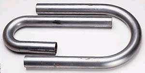

first image is mandrel bent pipes. press bent is the second image. mandrel bent pipes are the same size the whole way on the inside, press bent pipes arent and can restrict flow. mandrel costs more $
ID:	40895   Click image for larger version
