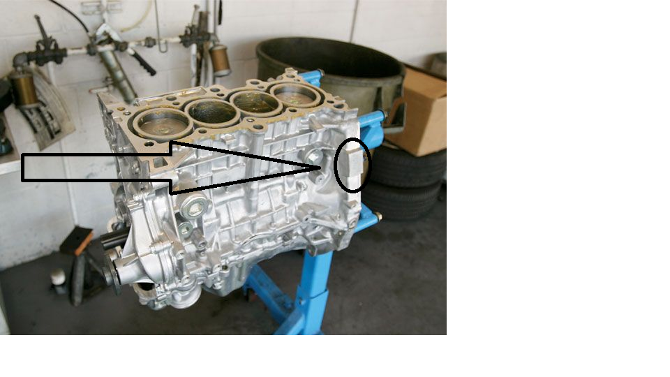

You probably only need the engine code. Maybe R18Z1 ? (I'm too lazy to go open the hood of my 12 and look LOL)
Find your engine code stamped in this area (pic below)
