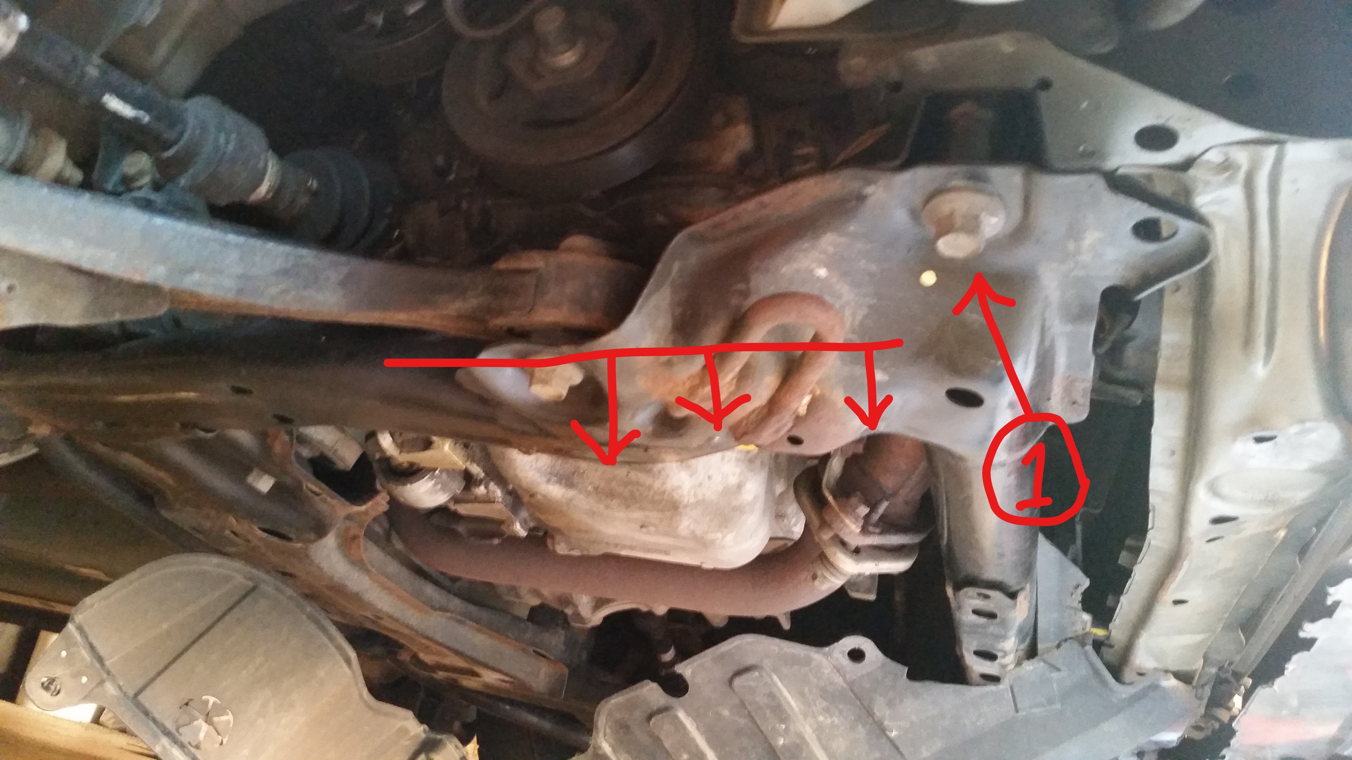

Re: A/C Issue
(08 Civic, CP Manual)
I think my Coil is bad.. so I am changing the clutch system. I can not get the ac pulley off. It moves less than an inch , but can not get it to come out. Is it possible to open bolt number 1 in attached photos so I can lower the frame (?) maybe an inch so I can put a puller on that pulley?

Old May 17, 2018
Re: A/C Issue
No the subframe(pictured) will not drop unless you remove or loosen all of the bolts all the way around it.
I may (depending on circumstances) disassemble the engine mount from the passengers side so the entire drivetrain can drop an inch or two, then use a pry bar to gently push the engine toward the drivers side to gain the necessary clearance to slip everything off the front of the compressor.
Did you find the thread about an 8th gen 1.8L, may have been regarding a 2008 model....where I posted a ton of pictures, replacing the compressor clutch while the compressor is still bolted in place?
