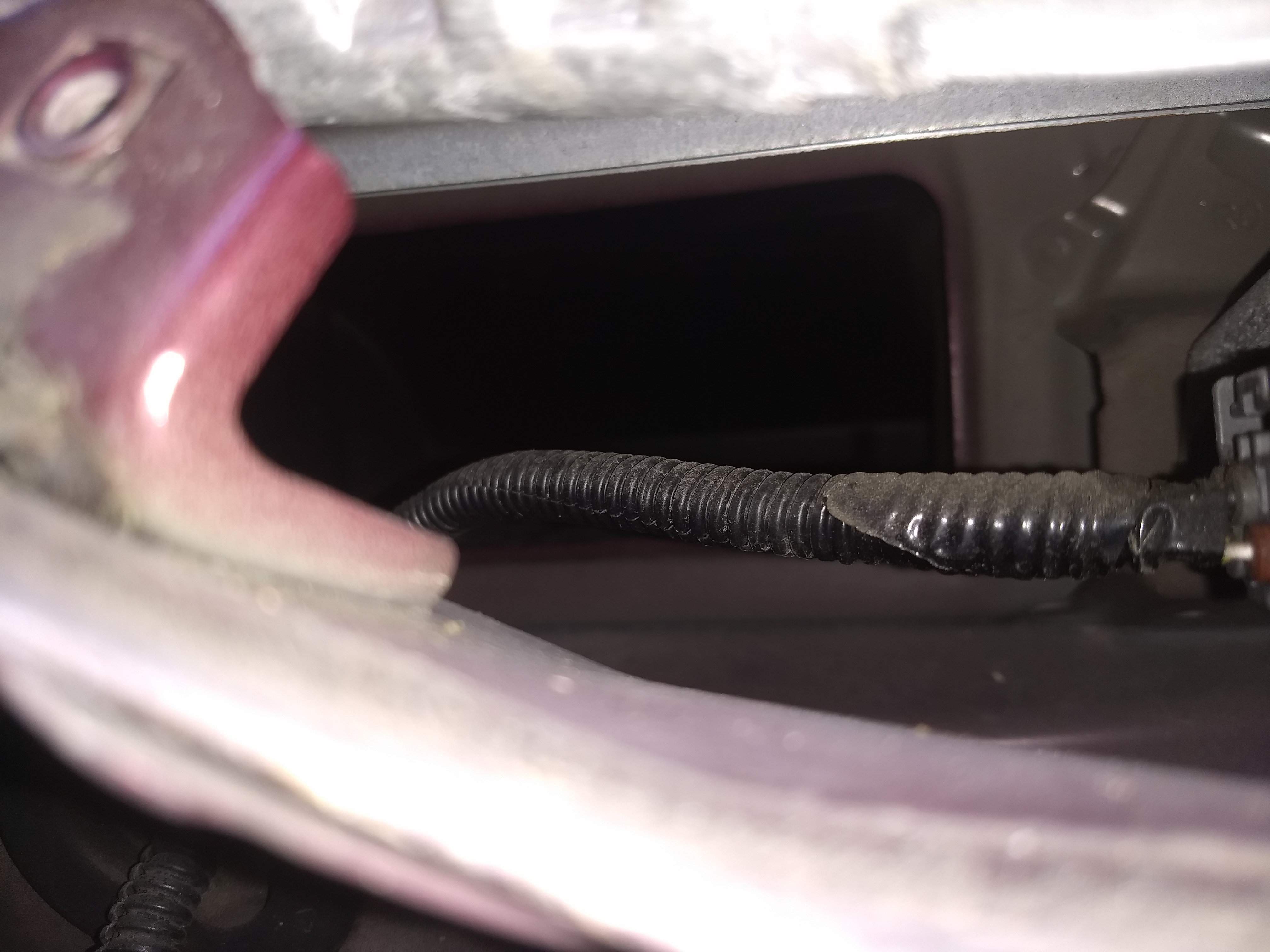

I have the same rodent issue on my 2012 Civic EX sedan. I've removed the plastic cowl and the metal tray panel thing that goes underneath it, but I'm not sure where I should put my metal mesh.
My guess is that it's the rectangular hole on the passenger side of the engine bay, up against the cabin. Is that the right spot?
Here's the best picture I could get of what I'm talking about:
It looks like it's going to be super annoying to access.

Nevermind, that's totally it.
I had to take out the wiper linkage to be able to access the intake opening and do anything to cover it.
I'm going for 1/4" hardware cloth and aluminum tape, because they're handy. I could probably use short sheet metal screws to attach the mesh, but I don't want to drill into something and ruin it.
