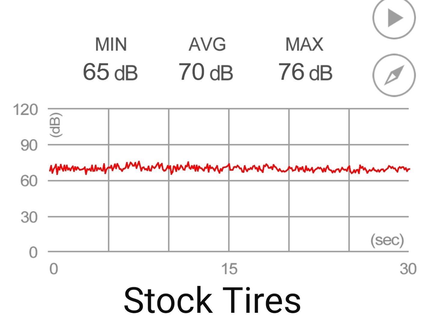

Results are in!
New tires are significantly quieter, and a surprise result with my old tires vs. my girlfriend's!
It would appear that the stock tires are simply loud. My old worn out ones averaged 70 dB, and my girlfriend's (which only have 12k miles and have been properly rotated) averaged.....70 dB!
Meanwhile, with my new tires (Yokohama Avid Ascend - H rated) I averaged 66 dB.
dB is a logarithmic scale, so the new tires reduced the in-cabin noise level by around 60%.
All measurements were taken on the same stretch of highway, at 70 mph (cruise control) and in the same lane. No other vehicles were around at the time of the tests

Is that dB meter a smartphone app?

Yes, but (below 85 dB) it's fairly accurate. I'm pretty deep into car audio and have measured it alongside real high-end meters used for competition.
Under 85 dB it was always within 1-2 dB of the competition meters (Pointless for most car audio, but sufficient for this use IMO).
(Pretty sure 85 dB is the upper limit of what my phone can measure)
