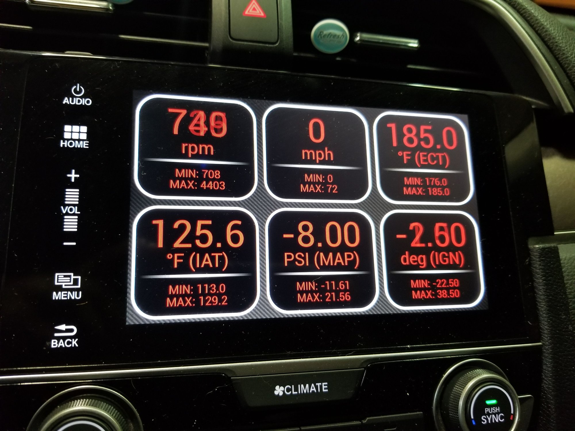

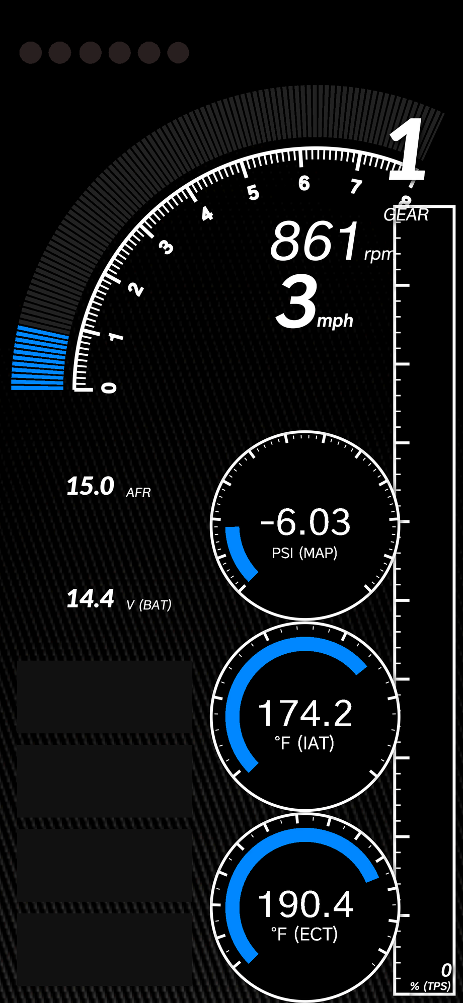

What app are you using for that sensor output?
Old Aug 14, 2019
Rep Power: 511
Re: Better air flow through fog light housing
I have a KTuner v1.2, so I'm tuned to 21psi. It doubles as telemetry with their $5 app

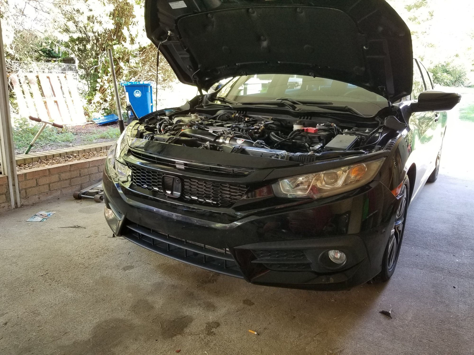

Figured I'd share some findings when I took off my bumper for the horn install. There's no direct path like I was hoping adjacent to the FMIC cold pipe that leads up to the throttle body. There is, however, a large void space behind the fog light area going into the fenderwell, pretty much where CAI filters sit. Also, if you take out the entire intake assembly, you can probably fit a baby or 2 in the space that the intake and resonator box occupies. I'll update with pics when I get home. Currently sitting at a VA health clinic waiting to get blood drawn

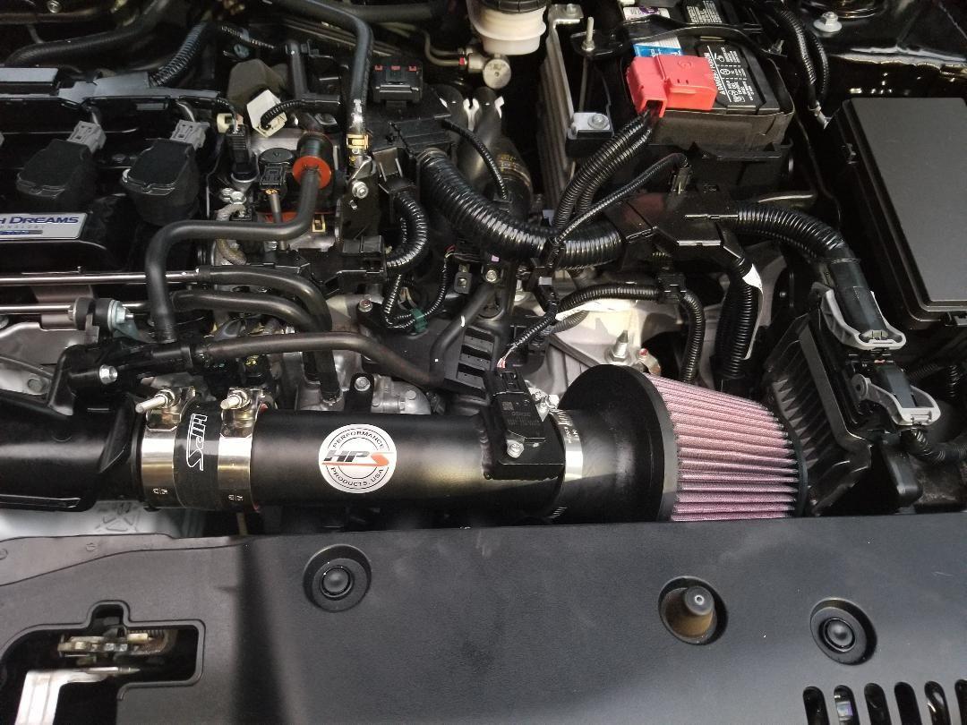

Sitting at a VA hospital. That sounds like fun. My HPS intake just got here, think I'm going to install it as a short ram today and save the bumper removal fun for this weekend.

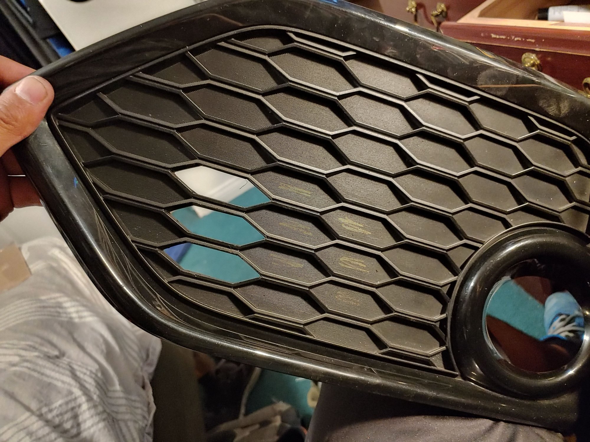

F'in hell this is a pain in the *** to do. I'm not using a Dremel because it tends to melt plastic and cut into crap I don't want to damage. Over on civicx (yeah, I see you're on there, too. Lol), there's a dude that said he used a box cutter, so I'm following suit. He allegedly spent 5 hours per side to do the entire thing. I'm only planning on doing 9 (to match the horn cutout on the passenger side), and these 3 have taken me a freaking hour. I've already committed at this point.
Old Aug 22, 2019
Rep Power: 511
Edit: apparently it decided to take my text out....
Made a little more progress this morning, Only took me an hour and a half for the remaining 6 holes I wanted to cut out. Figured I'd save my hands and look up how to use a dremel and not melt the crap out of the plastic. I literally googled "cut thick plastic dremel." Turns out Dremel has a tutorial video for how to use a dremel to cut out RC car bodies. Yes, I know RC car bodies are thin plastic, but their video didn't melt the plastic when it cut, so I figured it was worth a shot.
They recommended to use the detailer's grip and a 561 fluted cutting bit. Lucky for me, the dremel kit I bought included both of those. It still grabbed a bit and cut into some pieces I didn't want it to, but it was a whole hell of a lot easier to do than force a box cutter through 1/8" ABS. And yes, I found out that the faux vent is made of ABS by giving the backside of the vent a wipedown using acetone. I did it on purpose to find out if it was PE or ABS, and the almost immediate melting told me it was ABS, and I'm kinda glad it is. Was able to smooth out minor blemishes and fill hollow parts on the back with ABS glue I made a while back. Makes it a bit easier to figure out a way to mount the intake "stack" to the backside of the vent. At least these opened holes will allow air to enter the engine bay thanks to the architecture, so I theoretically should be seeing a slight decrease in IAT temps. Stage 1, done. Stage 2: fab up the inlet. Stay tuned, kids

You can do it without taking the bumper off. Kind of a pain in the ***, but doable, for sure. 3 clips/tabs you have to release on the top, one on the outboard side, one inboard side, 2 or so on bottom, and one plastic bumper clip on the inside (accessible once you release the top 3 and outboard clips/tabs). I have a plastic panel prybar set ($5 on wish.com lol) and it was able to separate all of the tabs without remotely scuffing the paint.
btw, I decided to make a thread dedicated to the IAT monitoring.
Intakes and IATs - An ongoing comprehensive study
the tl;dr version of it. removal of those 9 hexagons in the honeycomb showed a slight but noticeable drop in average IATs

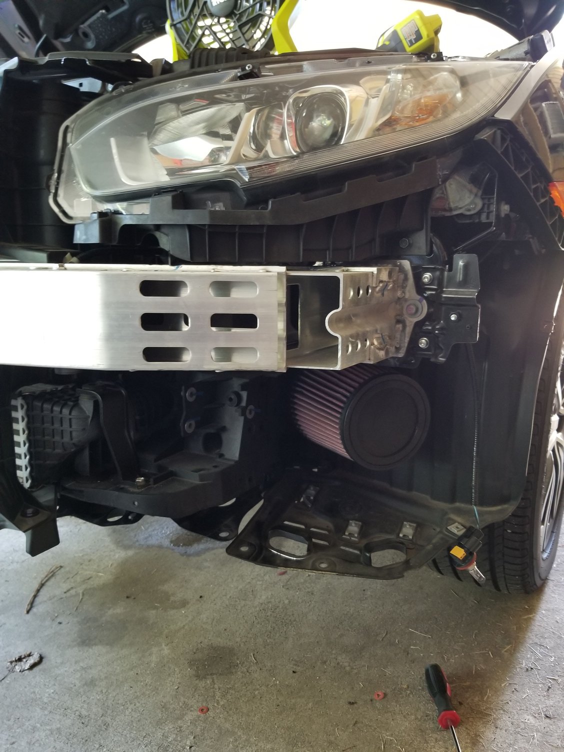

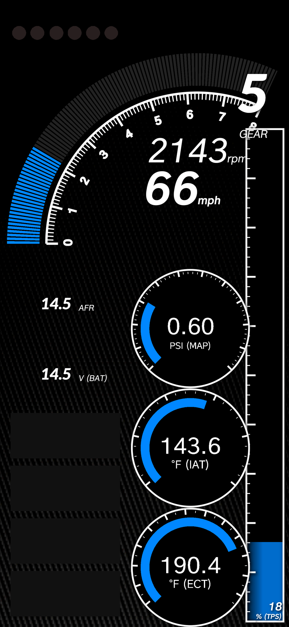

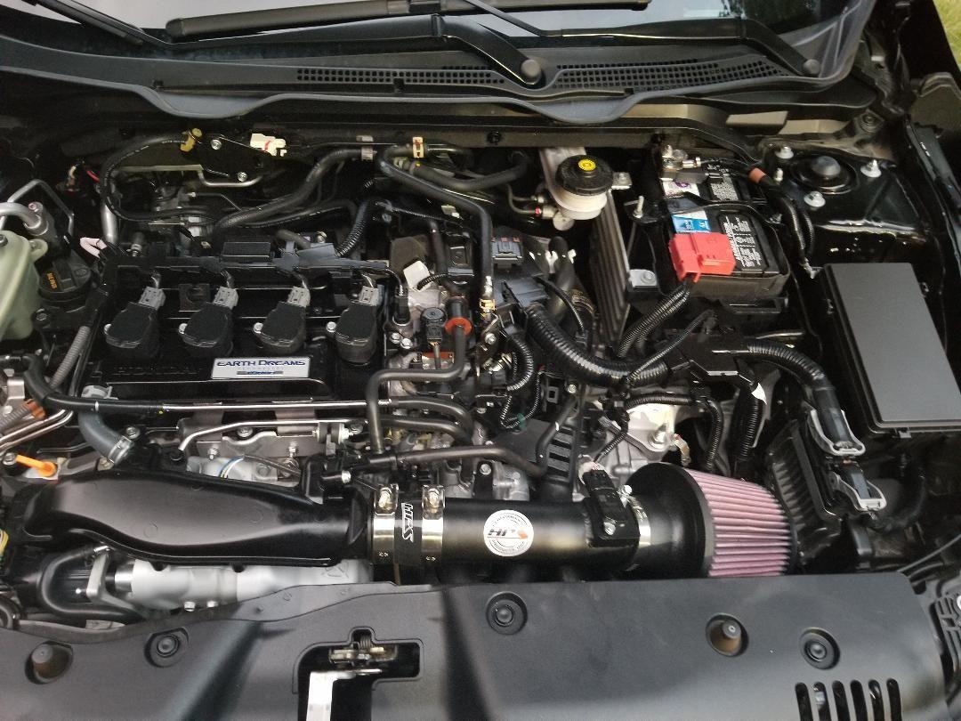

I got started with CAI and honeycomb grill install today, I got top IAT temps around 40 over ambient sitting still then dropping down to 10-15 over ambient when I got moving with the bumper off. I also got sanding down the leading edges of my wheel well liners which I didn't see until I got home. Planning on finishing up tomorrow and then I will further report.
