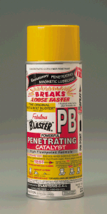

For the other bolts here's a trick.
Go out and buy a can of "Blaster" Penetrating Spray. Hit all of the other bolts and the stripped one too with the stuff. Let it sit for a while. Then spray them again. Let it sit, then spray again...you get the idea...
When I did headers (on my truck) I had the same problem. I sprayed all of the bolts with that stuff (following the procedure above) and the manifold bolts came out a lot easier.
As for the stripped bolt? I'm not sure. I would have suggested the Craftsman route! lease:
