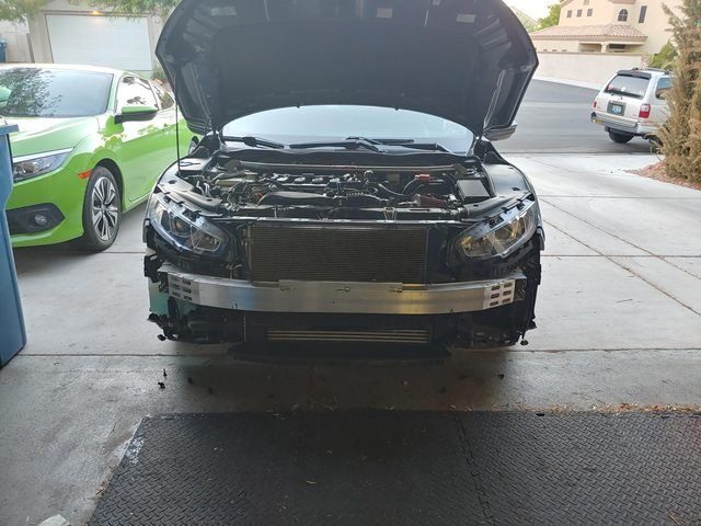

  1. Take off your front bumper and set it aside (video here)
    1. In the engine bay, there are... a **** ton of clips you'll have to remove. Easily done with a flathead screwdriver. above each headlight, there are 3 smooth-top clips each on top of the weather seal. They're a bit of a pain to take off, but doable with a flathead, even easier with the plastic fastener removal tool. They also make a very disconcerting cracking sound when you pop them off. Above each headlight, right on that trim piece, there are 2 slots each. There's a clip you have to depress to release that trim piece from the headlight. That 5mm allen wrench I said you needed works great here.
    2. In each fenderwell, there are 2 Phillips head screws each.
    3. Under the car, there's a massive **** ton more clips, 2-10mm bolts (on each far end), and 2 hex head bolts you'll need that 5mm allen wrench for.
    4. Once all those clips are removed, Start at one fender and give it a good yank. Some recommend using a flathead or something to release the clips on the fender and headlights, but a good yank will do just fine. More disconcerting crack sounds, but they release with good yanks.
    5. Once all of those are released, you can probably feel the bumper wanting to come off. If you have fog lights, BE CAREFUL. You yank the bumper off without disconnecting the fog lights, and you'll find yourself re-wiring those, too.
    You should now be staring at a bumperless car. Congrats! Now navigate to where the passenger's side foglight was (or would be if you don't have fogs)

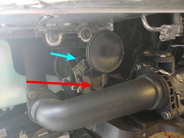

  2. Look at this wimpy *** thing. Lol. Disconnect the pigtail from the horn and use a 12mm socket on the bolt with the red arrow. You can now take your horn and set it aside, throw it at your neighbor's cat, set it on fire, etc. I took off the bolt marked with blue to take off the OEM horn bracket so I could fit more in that small space. I'd recommend it, too.
    1. Furthermore, you see the FMIC pipe right in front of that OEM horn? 4 bolts holding it on, all use a 10mm socket. Take that sucker off to make your life easier. Don't worry, it's a rubber gasket. You don't have to replace it when you break that seal. You may want to take it off prior to tackling the horn bracket, truth be told..

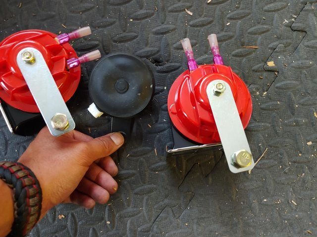

  3. Lets take a minute to compare the OEM horn and the Wolo horns.
    These suckers are so much bigger than the OEM one. Now you may have an idea of why I didn't take very many pics during the install, since I had to finagle these guys in place so they wouldn't hit anything, rattle against anything, nor would they snap off wiring. Attached to the horn's spade connectors, you can see the purple female spade connectors I used. They have adhesive lined shrink wrap attached to them. They're quite fancy.

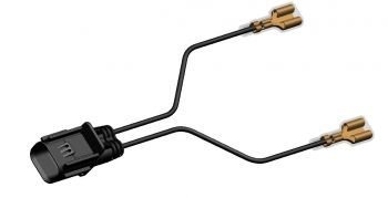

  4. Here's the horn adapter harness, and I don't have my own picture of it, so here's from College Hills Honda's website
    image source: https://www.collegehillshonda.com/product/0S18.html

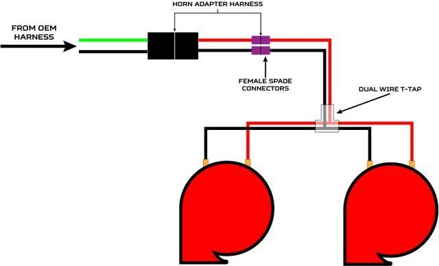

    I guess earlier iterations of this harness didn't plug into the 10thgen horn pigtail, but this one does. I can personally attest to that. With everything taken apart, use this time to figure out how you're gonna wire all of it. Wolo states that it doesn't matter which spade connectors is positive or negative, just that you're completing the circuit. Whatever you choose to do, just make sure that you're wiring these guys up in parallel, not series. Below is a wiring diagram I drafted up for you guys. Sidenote, I've also seen people use those piggyback spade connectors, too, but I couldn't find any, hence my usage of those t-taps.
