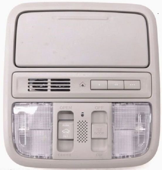

Whichever console you get, make sure it looks like this:
and not like this:

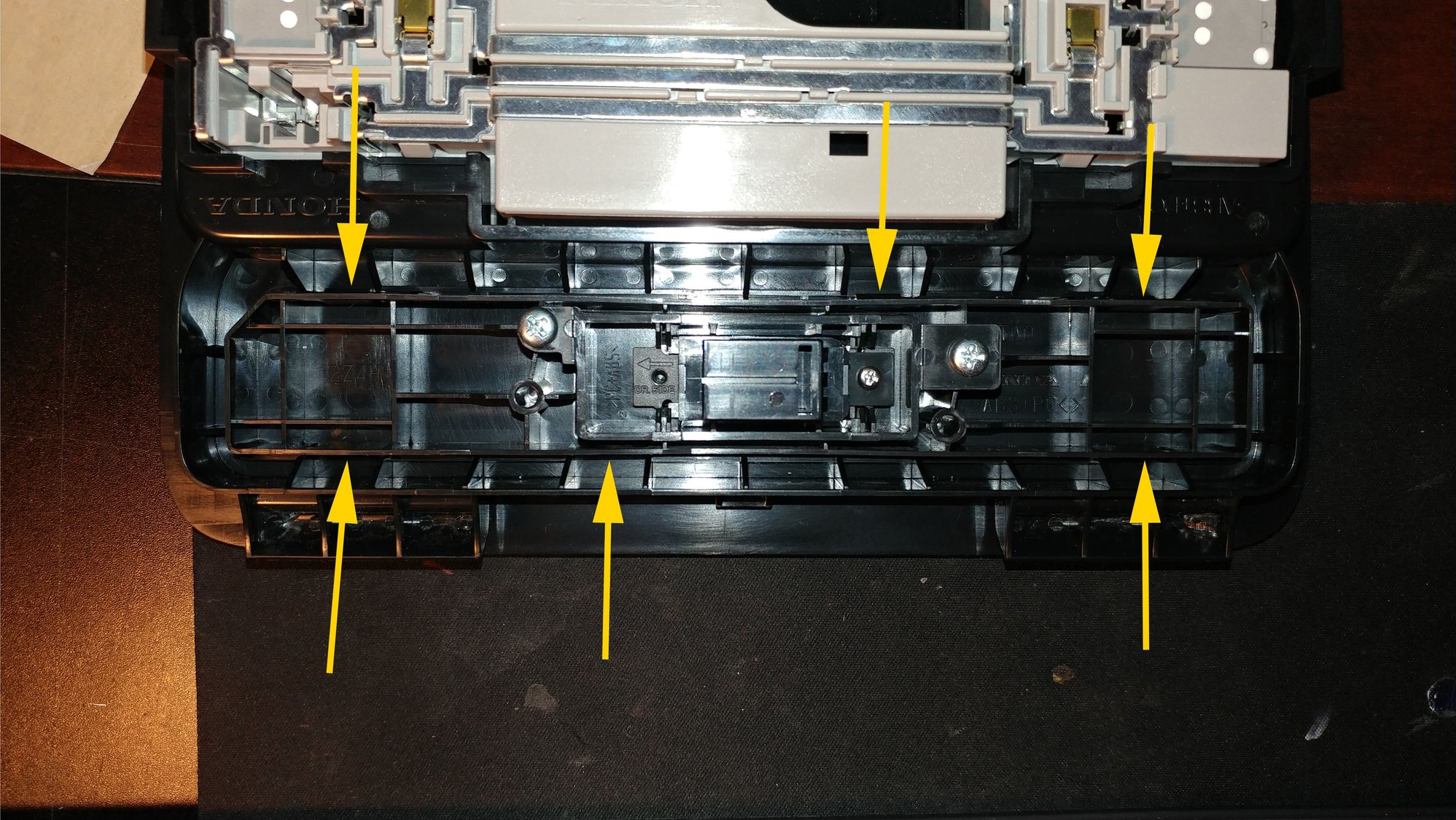

  2. Remove the microphone assembly from the console by depressing the 6 clips on the border of the assembly. It should push right through once all 6 clips are released.
  3. This is what you should be looking at now. Put that aside and grab the assembly you just took off this console.

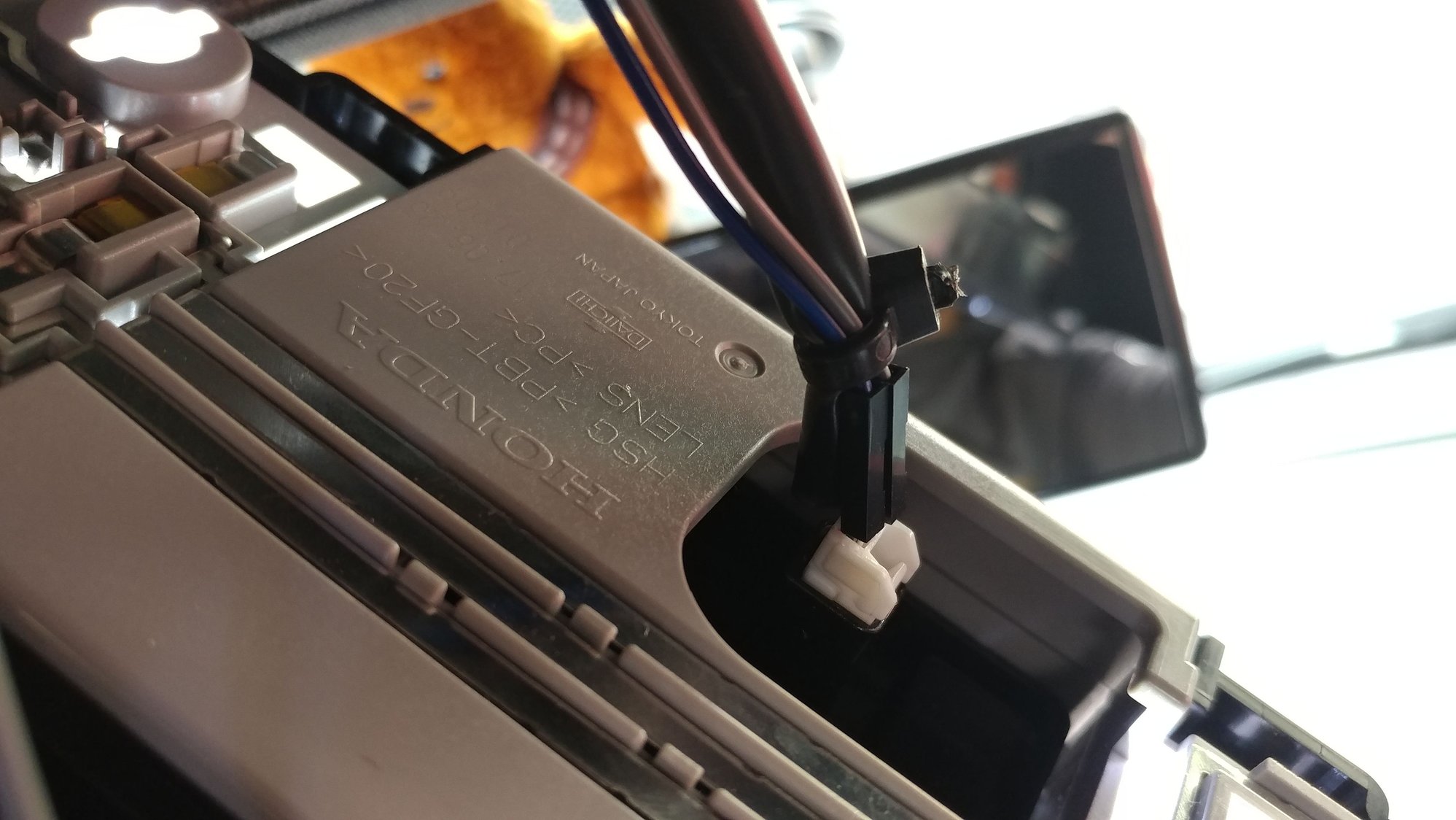

  8. Bring the newly assembled map light unit to the car. Find the small plug that connects to the forward-most port on the map light console. This is power for the accent light in the console. Connect pin 1 to the blue wire, and pin 4 to the grey wire.
    Zip tie or electrical tape it in place. Plug everything else in (yes, even with your microphone positioned inches to the left, it'll still reach).
