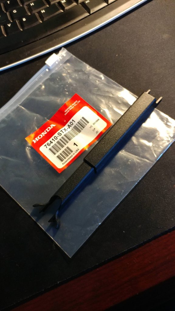

  2. Meet the wire harness cover. The thinner bit slides in the larger bit, allowing it to be friction mounted to the car.

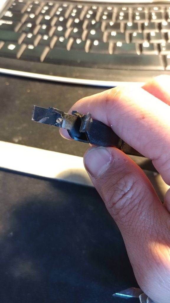

    1. This thing was designed for the sensing mirror which mine was not equipped with, which apparently has something to accept the clips in the middle. My mirror doesn't have anything to accommodate these clips
    2. There is, however, a small space between the mirror base and the windshield, which is probably 1/16". I used an exacto and wire cutters to get the bulk of the material off, and used a Dremel with a sanding drum to make it pretty. ***IMPORTANT*** Take note of the orientation the harness cover is in in the second picture. The 1/16" thick bit of plastic was left on the open side of the harness cover (the part that sits against the windshield). Yeah, that's my bad for not taking pictures of the thing in the same orientation. I'm merely testing your attention to detail. lol

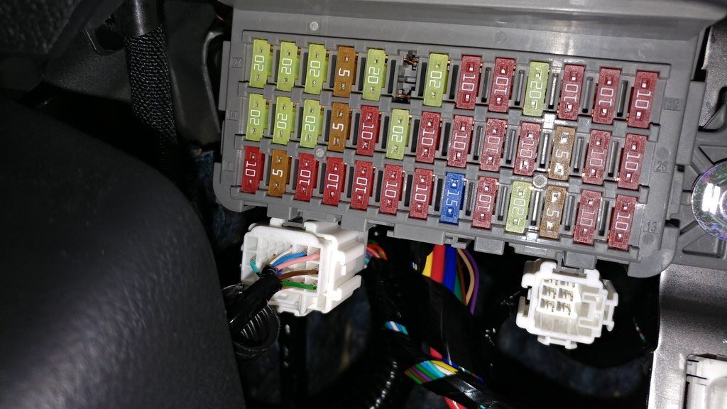

  5. Meet the CivicX fusebox

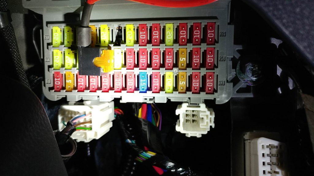

    My car isn't equipped with CMBS (collision mitigating braking system) and thus, the fuse in slot 17 is powering absolutely nothing. It's also constantly hot when the car is in ACC mode or on, so it was the perfect candidate for the fusetap. Remove your fuse of choice and replace with the fuse tap. Ensure the lead (that you presumably connected to the power supply) is in the same orientation as this:

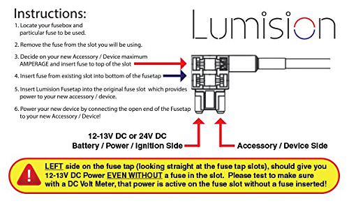

  6. How to use the fusetap
    For the OEM load from that fuse, put that fuse in the "bottom" slot. For the new load you added, that fuse goes on top. Considering the output for the power supply is 1.5A, I figure the power draw is stupid low, and a 5A fuse would suffice here. I'll update if by some stroke of bad luck that fuse blows from this low load.

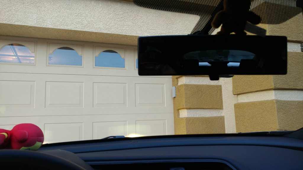

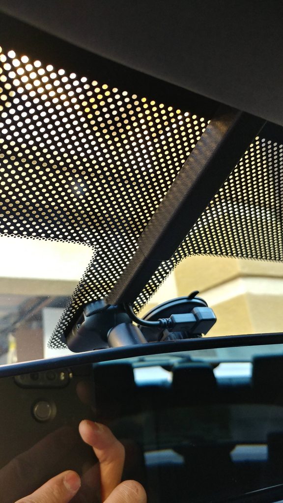

My installation, dash cam not visible from the driver's seat
Passenger can see it just fine, though
