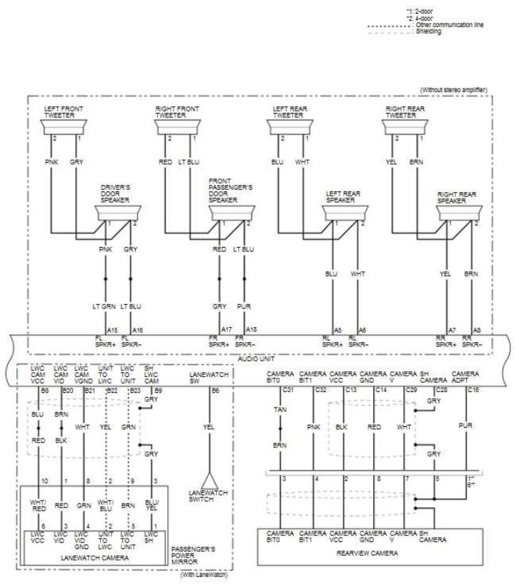

Any info to be found for stereo pin outs to pick off the high level outputs to feed to a line level converter?
Old Jul 15, 2020
Rep Power: 513
Re: Options for 2016 EX-T audio upgrades
From what I've seen, people been tapping the rear speaker lines (output from HU) into their LOCs (e.g. LC2i/LC7i) for ease of installation, but you'll get better results if you use the front speakers.
I don't have pinouts, but here are wiring diagrams
And for those of us without an amplified system:
