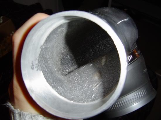

my current intake, which ive been using for 6 yrs, is a WR secret weapon with AEM dryflow filter. You can see the air plenum above the throttle body, and the intake pipe only has one mild bend in it. The IAT sensor is located behind the pcv hose, mid-pipe. The plenum pipe is spaced 1/4 inch above the throttle body to prevent heat transfer. There is a custom bracket mount holding the pipe in place. The dryflow filter does not get anywhere near as dirty as the oiled versions. I've had it for 6 months and there are only some twigs and leaves in it. the media is thick, like two K&N filters combined (you cannot see light shining thru the dryflow media). Removing the factory airbox and resonator also allows better airflow and cooling of the trans and engine (with altezza style front grill). All of the couplers are silicone, no chance of breaking or leaking air. clamps are tightened with a socket wrench. By far the best intake i've had compared to K&N typhoon, AEM SRI, K&N FIPK, and a few others. Those only lasted a few months before I got tired of them. I would like to eventually replace the air filter with a DC sports velocity stack dryflow filter, but they are impossible to find without buying the whole intake.

oh okay good to know. i havent read those yet. and your intake looks really good in the above pic. i heard about the icebox a while back, its too bad they never made anything for d17. i guess the battery would have to be relocated with that kind of airbox setup. i wonder what would be the best pipe bend angle, cause i remember reading an article while back that said 90 degree bends would slow down airflow enough to be measured with a meter. but again these are small details. it won't make or break the engine. im sure the air is still able to move fast enough to supply the needed air. i'll read that long thread later today looks interesting.
forgot to mention, the WR above uses a 3 inch main pipe and universal AEM dryflow filter (thats why its red instead of grey, they only have red in 3 inch size).
