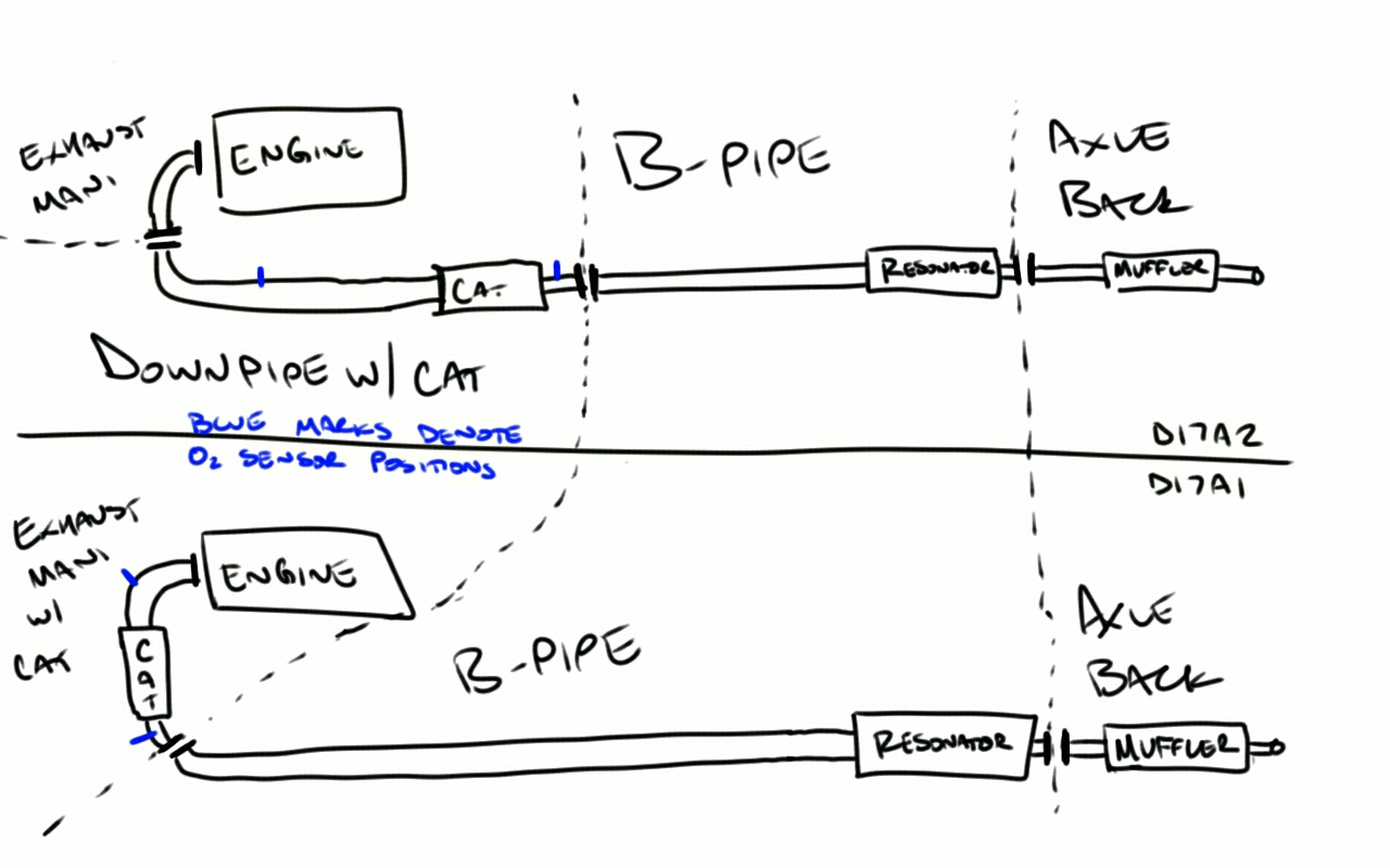

PasswordJDM, I believe, sells PnP O2 sensor wiring extensions. That way, if you ever wanna go back to stock, you can.
If the cat-back you're looking at was designed for a D17A1 (lx/dx) then you can just install and go. If it were made for a D17A2 (ex), then you'll have to swap out your entire exhaust system (exhaust mani and all)
here's a drawing I made way back when illustrating the differences in the D17A1 vs D17A2 exhaust systems. Should give you insight as to what would be compatible with what. And yes, an ex header/exhaust mani will bolt right up to a D17A1 head.
and, since I explain everything as if the reader had zero base knowledge (or for the edification of a newbie lurker), a cat-back exhaust would include the b-pipe and axle back portions.
