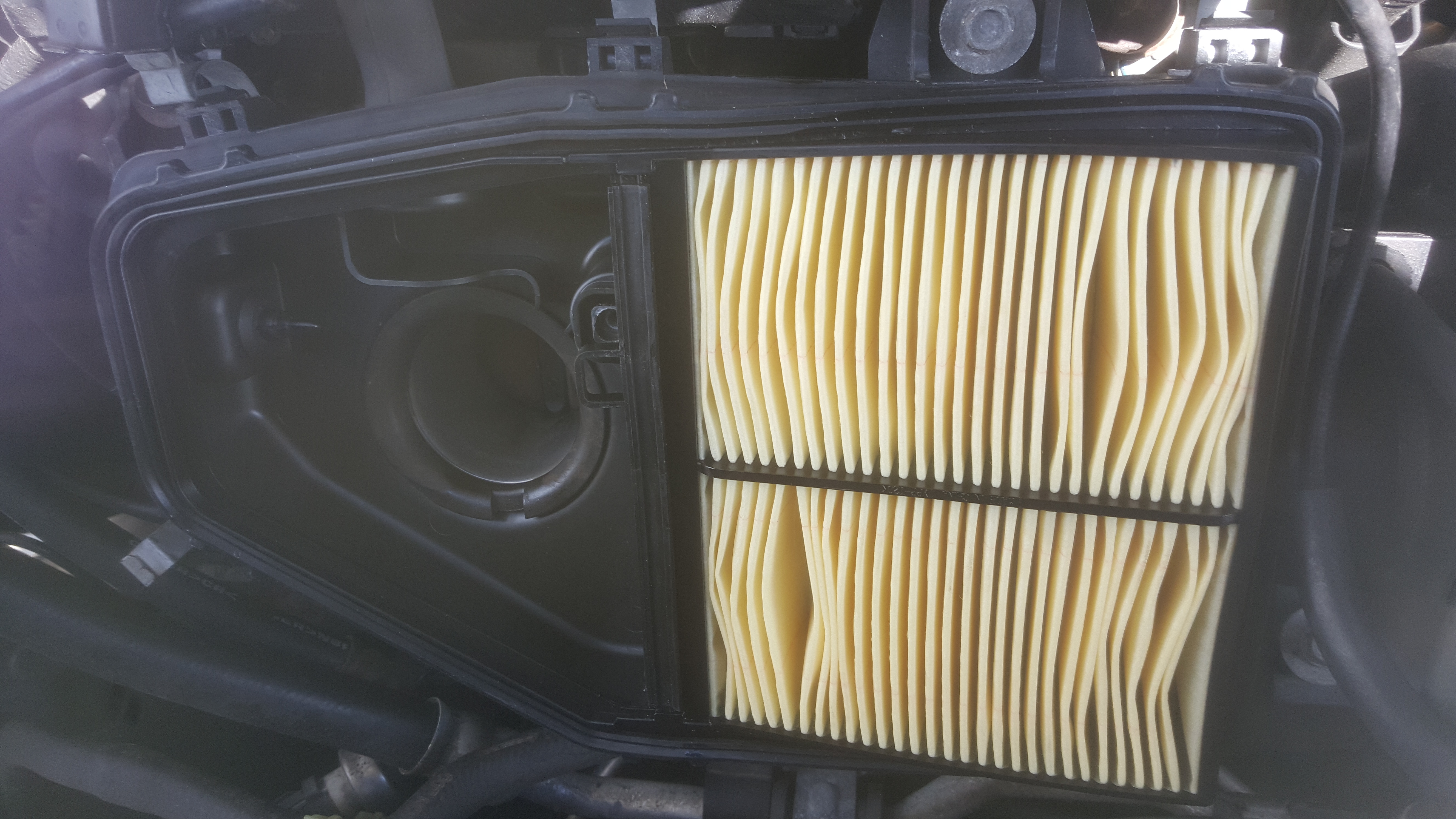

So I went and got the Honda part and it still didn't fit. I tried the STP filter still had an issue. Is there a case where the air box is from another Honda? on the box it says HONDA PP-TD40 CC6

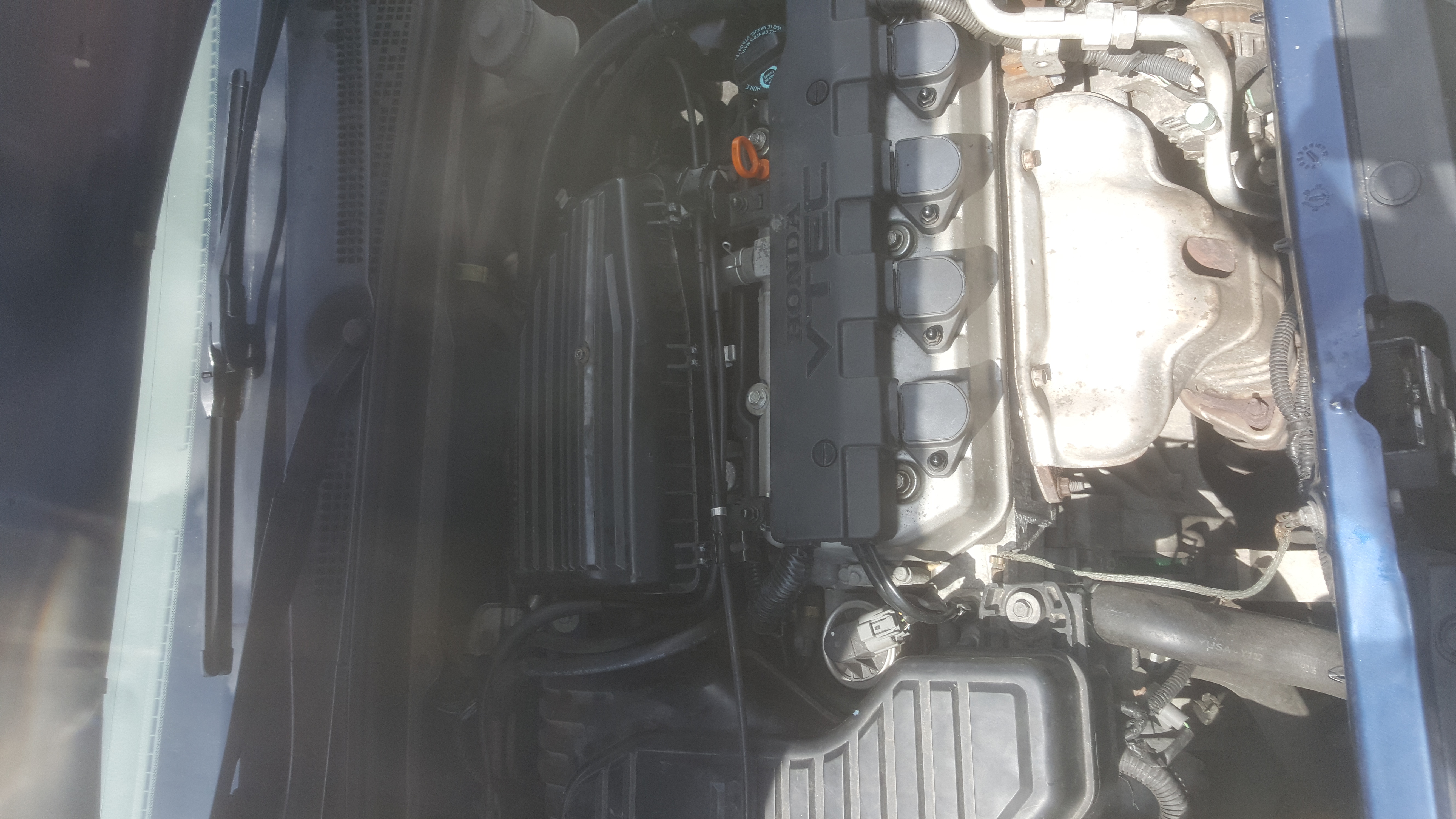

that air box is close but not quite right, someone put in different replacement maybe?
that part number comes up as a honda jazz part on ebay using google

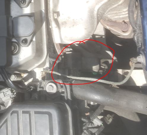

My airbox has clips, every video I have seen so far shows the air box with screws. Not sure what to make of it. My engine has blue writing on it, and it says Oil in German and also Oil in English. I am not sure if that matters. But I included the pictures for reference. I guess I am not sure where to go from here. The car needs an air filter LOL
ID:	90044   Click image for larger version

Where I circled in red shows the engine number, What does it say?
Did someone swap the engine in your car?
Do you live in North America? Or in Europe?
You can also buy an aftermarket air intake and filter and be like all the cool kids

I live in North America. I believe the engine was swapped. Is says First row: D1 5B
Second Row:3800090

So a D15B?
https://en.wikipedia.org/wiki/Honda_D_engine#D15B_VTEC
I don't think that ever came in a North American Civic. Previous Owner must have had the engine swapped with one purchased from an importer. Engine runs good? No check engine light?
Is there a place in your city that imports JDM car parts? They might be able to help you find a filter. Or you could get a normal 01-05 air box from the junkyard but if you live in the rust belt than the screws are probably junk and wont keep the air box sealed. Or buy an aftermarket air intake and filter. You can usually find them used for cheap
