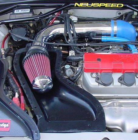

I have a 2001 civic ex and my first mod I'd like to do is changer the air intake. I have a HPS SRI. I originally wanted to install it but now I know I would lose HP because it would suck up hot air in the engine bay. So my question is has anyone made an icebox and what material did you use? I've seen one that looks like the links below in another much older post. That's something I would go for.

edit: However, to answer your question, it wouldn't be terribly difficult to fab one up yourself. Find a way to get the general shape (wire mesh?), may down some fiberglass mat on it, paint if you please. It's not load bearing nor structural, and 2-4 layers of fiberglass mat can be strong as hell. Fiberglassing isn't hard, just messy. If it's hot, not even time consuming. Or, if you know someone with a 3D printer, even better

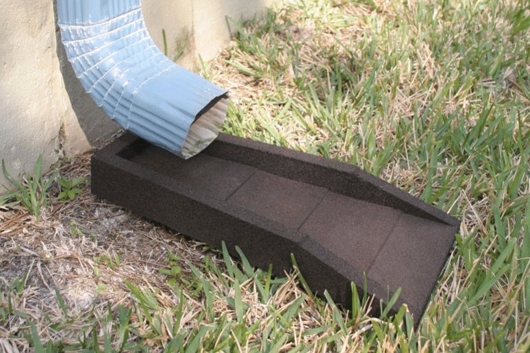

Go to Home Depot or Lowes and buy two downspout splashes (pictured)..put one on top of the other face to face..LOL
OR..just go back to stock air box
