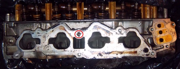

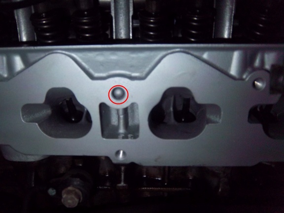

On the back of the cylinder head, near the top, center, is a hole with a ball bearing in it, and I'm thinking it's a spring-loaded ball valve for a scheme for recirculating exhaust gases through the injector block to pre-warm the fuel.
The thing is, the rebuilt cylinder head that I just received has a metal paint, stain, or coating, and that pea in that whistle is now painted. I suspect that the paint has stuck it in one position. Should I give in to the temptation to give it a little tap to loosen it?

Post a picture of whatever you are talking about.
Don't touch it yet, whatever it is.
I'm thinking of a steel ball, staked in place to plug a passage for a damn good reason. The oil pressure feed for either the cam journals or the VTEC oil passage drillings.

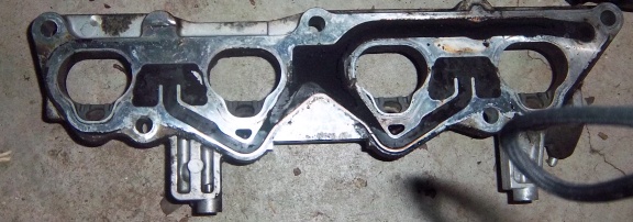

Thank you so much for replying. Here are some pictures. It looks like the port opens up to a flat surface on the injector block outside of the gasket.

Old Jul 13, 2014
Re: The pea in the whistle
None of these.
It is not spring loaded. It's staked in place and not intended for anyone to tamper with it.
Absolutely not.
Don't touch it.
The steel ball is used as a plug for a drilled passage in the head (usually for an oil feed).
The old head should have had the same thing on it.
I can't see what's in there myself, I'm assuming it's a steel ball as you described.
