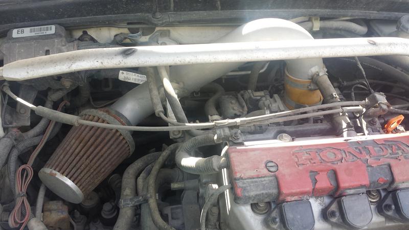

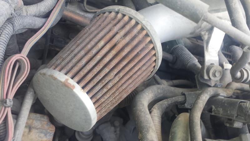

I just bought my Civic 2.5 weeks ago. It's a sweet looking car with some upgrades but needs some serious TLC. I'm swapping in an engine with half the miles next week. The intake filter is in rough shape but there are no identifying marks. How do I figure out what replacement filter to get?
Thanks!

It looks like just a generic filter.
The cone style filters come in various sizes so you can measure that one and look online for one of similiar size or go into a parts store and get one of similiar size. It doesn't need to be the exact size.
K&N has a filter finder on there website where you put in the dimensions and it tells what kind they have that is close.

Just measure the length and radii of the opening and cone and order an AEM Dryflow. They're supposed to be the best.
