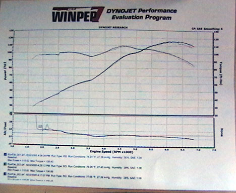

well i'm not disappointed but i'm not impressed either. Here's my mods:
Iceman intake
HP racing shorty header
Megan downpipe
2.25" custom catback to a DC5 ITR muffler

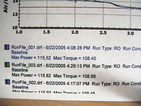

Run 1 = 115.52 max HP 108.40 max torque
Run 2 = 115.82 max HP 108.89 max torque
Run 3 = 115.92 max HP 109.45 max torque
I did do a fourth run with no air filter just to see if it was to restricting from it being dirty and I actually lost 1HP and 2ft-lbs of torque. Weird.

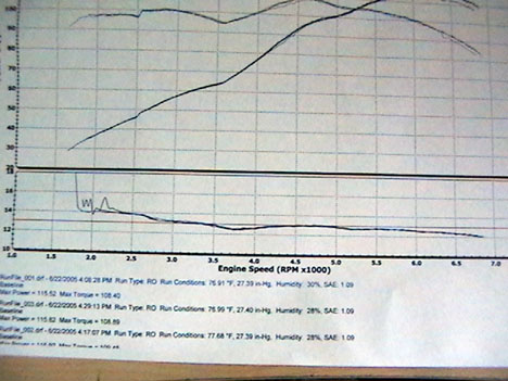

My a/f was lean at the begining (1800-2400rpms) of each run and got steadily rich to redline. There actually was a rich dip at (3500-4200rpm). You'll see as soon as I get the graph posted.
Let's just say i'm glad i bought all my stuff (except iceman intake) used for cheap. no crazy gains here.

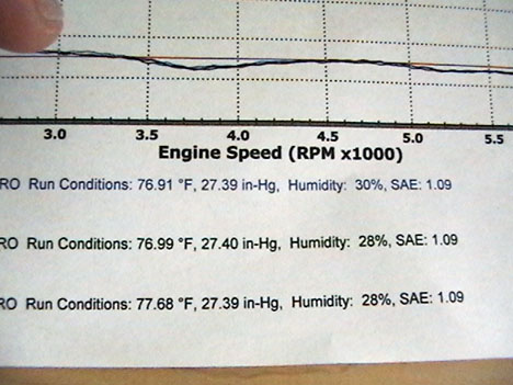

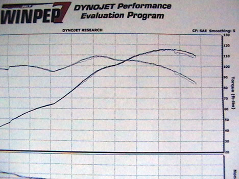

Here's the pics:
BTW i don't know how altitude affects HP/TQ but edmonton is 2200 feet above sea level. The run conditions are on the last pic.

fuel tuning should yield another 3-5 hp up top.

That a/f curve is pretty good actually. Fuel tuning may only get you a few extra hp across the board.
