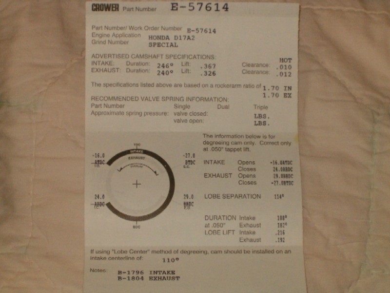

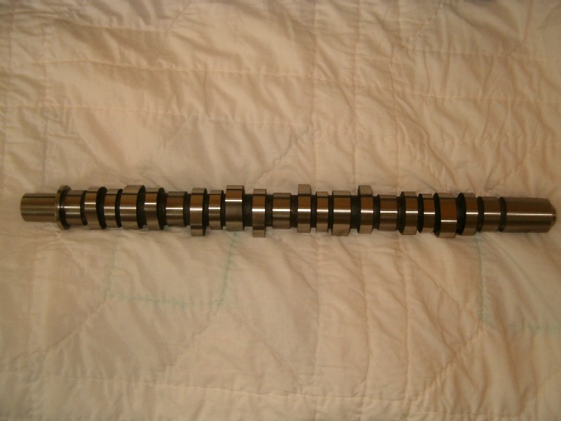

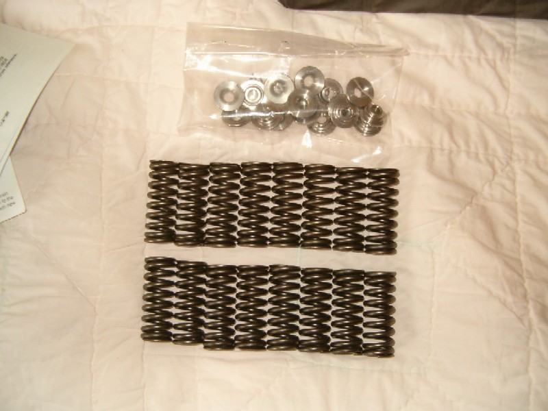

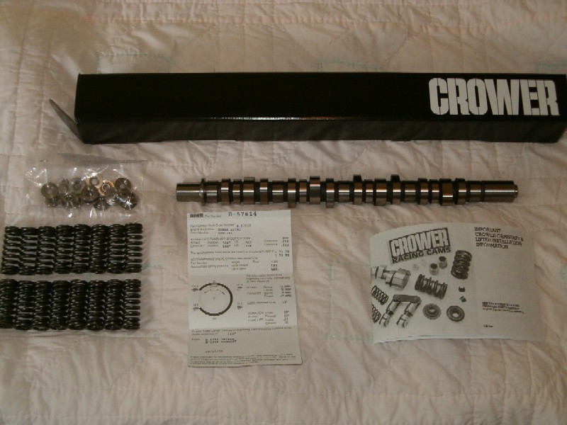

Going to shop to get this sh@t installed tomorrow.

This is the turbo spec cam.

No it has not been tuned but I am planning on getting it done within the month. The cam was 375.00 and the spring and retainer kit was 302.00. Whatever flat rate is on remove and replace cam and valve springs.

My shop only charged me 250 canadian to get the springs and retainers installed on my old CRX. and that was for a DOHC cam engine, so u shouldnt be that much. Retainers and springs is something u dont wanna **** up by doing urself, so may as well get the pro's to do it, and set valve lash and **** while they are down there.

just saved them specs, holla and some good and beneficial rep for u

was that one a regrind? or was that the brand new one everyone was talkin about a while back?
Old May 12, 2005
coperandy731's Avatar
Sounds like a serial killer. Is that what you are?
Posts: 48
From: Ft. Stewart , GA
coperandy731 will become famous soon enoughcoperandy731 will become famous soon enough
This is one of the new cams not a regrind.
Thanks for the rep. As you could tell I really needed that.
