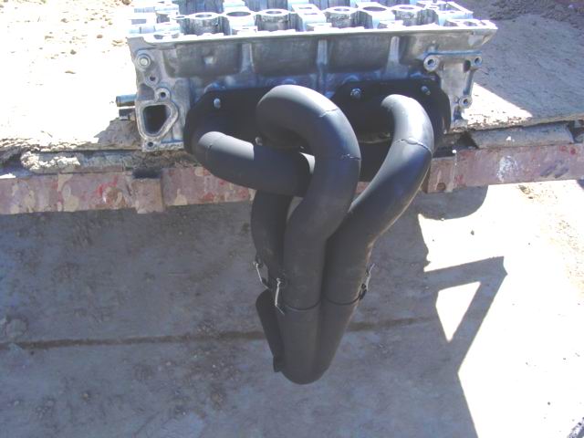

Here is an example of one of our NA headers.

Thats a Mean looking N\A header WOW!!!!

looks good and I don't give a **** if it is carb legal or not. It is a bolt on, so then I can just bolt it right off when emissions come along

If thats a picture of a header in it's final design stages EXPECT very little gains with that header, It may even harm your power curve. Unless those primary tubes are 1/2'' thick, that header is pointless... the primary tubes are double the size they have to be. Smaller primary tubes are used to keep the exhaust speed high in the header, which in turn, on overlap this exhaust speed is used to pull the air through the engine. Current header technology has proven that bigger is not always better on today's competition engine. Dyno results and track testing has shown that usually the best header combination is using the smallest size primary tube and merged collector throat. Track and Dyno testing has shown that you can literally choke a motor off by using too small of a header, and further testing has shown that you can hurt power and acceleration by using too large a header as well.
I'm sorry Catalyst... Please do not take this as me dissing you and your products (You do make Very good turbo kits BTW) But i'm just looking out for my fellow 7thgenners...

it looks more like a turbo manifold with all those crazy bends in the primaries at the top.... i'm still interested though... wanna see some new products out for the cars

the pipes look a little big, but as he stated above
"Here is an example of one of our NA headers."
of course they will have lots of R&D.

now he gave that as an example right? I'm assuming something that large would probably be built for a a built b16/b18. PnP head, and as much airflow as possible, although Touge_Motors has a great point, i don't think that head would ever be used for our cars.

Yeah, was that header for us?

The car it went on went 12.8 before the header.
it went 12.4 with the header.
This is a completely NA motor on pump gas.

Also to answer the other questions...
That is most definately not for our D17 motor. That was for a car that will be a big competitor in the Street/NA class.
Of course, that header was built for a motor that was fully built. We will not be using such large primaries for a stock trim, or even mild trim motor. I posted that picture to let you guys see how our headers turn out. If you look closely, you can see the anti-reverberation chambers in several different spots on the header.

^^ I noticed that when I was first looking at it. It's a hell of a nice build. Probably wouldn't mind selling mine now and getting yours later, pending dyno <---as always.
