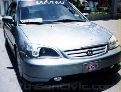

cold air intake draws air outside while the air intake draws air from the engine heat "fans"
here's my custom made coldair intake!!!
