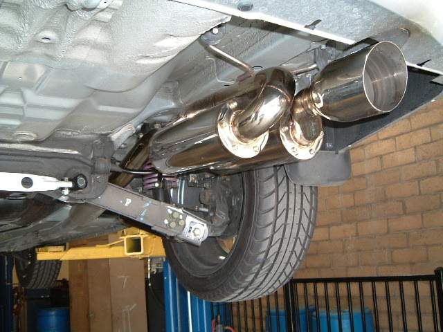

Ive had it before and I had all sorts of problems like the pipe hittin the sway bar and the exhaust melting my bumper . Look at the way its designed....it has to goto all that loop and 2 mufflers !! GHEY!! I think the TCS is all looks and it costs waaaaaay too much. I think the TCS is straightly just for looks. I know u dont get much HP with exhaust systems but this TCS is the lamest thing ive ever seen.

Dru, did you have it with a body kit? I've driven with it for 10k+ miles and haven't even started to melt. I've had no problems with it. I have yet to go to the track or dyno it. I felt good gains when I installed my exhaust. What sway bar did you have?

Heres a pic of my car on the hoist. The TCS was brunin it. It got worse . I'll never like anything thats DC........DC just plain sux!!

I dont know why it was doing that. Mine looks exactly the same as yours. I havent found any burnt or melting on the stock bumper. How long was it on your car? I like the exhaust and header. I havent used the intake, so I wouldnt know. I agree about the way dc sports have their strut bars setup. I dont agree on the multiple pieces.

forgot....maybe a yr

before i got my TCS, i saw a few threads saying that its a wise idea to heat the hagers on the rear section and pull them up(toward you). this will drop the muffler to the height you want plus it helps center the tip in the bumpers cut out area(if you care or do it right)
personally, i loved my exhaust and had no problems with it except for when i installed my RSX rear sway bar, but again, i saw on a few threads that the DC system is the only one that hits an aftermarket bar and i made the decision to live with it, it didnt do it all the time anyway.
now, if you say that DC sucks, youre also saying that Spoon sucks cause they have a muffler that is made pretty similar to the DC system. i dont hear anyone knocking that system except when it comes to price.
besides, on civics, the exhaust could have 1000 180 degree bends in it, you still would have the same power as before. DC dynoed an ex with the DAC, header, and TCS and got a total of 5 HP out of it, that means, at most the TCS is makin 2 HP. btw, all the other systems available make the same power, give or take .5 HP none of those figures are able to be felt on the "Butt" dyno, so whats the big deal?

BTW, you must not think DC totally sucks cause it looks like you have the lower rear tie bar
I came up with an even better solution. Stop in just about any exhaust shop and i bet they will have some old ruber hangers laying around. I changed just one of mine to one about 1 " longer this lowered it enough to clear the body kit . By changuing just one it also moved the exhaust to a more centered loaction in the exhaust cut out area.

Haha!! Yeah you caught me on that one. Well I didnt know any better at the time. I wouldve gotten somethin else if i wouldve known how sorry DC was. So yeah im stuck on that part
