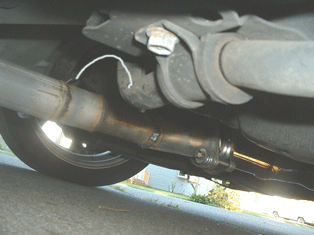

I did an oil change today and decided to take a better look at the EX front anti sway bar. I would somewhat understand how the LX sway bar would get in the way if it didn't curve upward around the cat but I still don't know what it looks like. I'll try to get a pic of the LX bar if I can later or if anyone else can do it who has an LX, it'd be much appreciated.

Posts: 2,846
From: Hawaii
Ahhh, I see. I can try to get a pic of my LX.

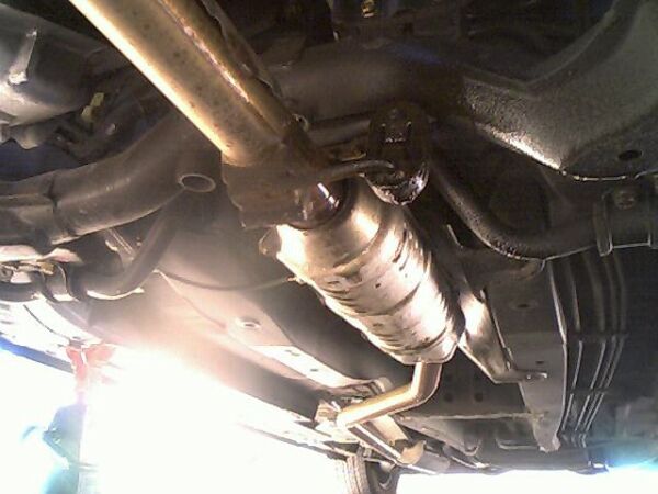

duno mines not in the way.. but then again.. i have no cat i took it out today..... ;-) lol i pointed out where it bends cause the pictures small...

Looks like the LX sway bar curves the same way. But I'm guessing the curve on the LX is smaller than the curve on the EX because the EX has a cat there and the LX doesn't. I don't think you'd have to modify or buy an LX front sway bar. It doesn't look like it's necessary since you're going for the LX exhaust system.
Awesome. Then it'll definitely fit. Much thanks for the pic, Chenz. The LX bar looks like it doesn't curve up as high, that's all. No wonder the HP header with cat won't work without the EX bar on an DX/LX.
Looks like everything's been mapped out. It seems odd to put an LX part (even aftermarket) on an EX but as long as it works, it's all good.
Thanks everyone, for your help.
