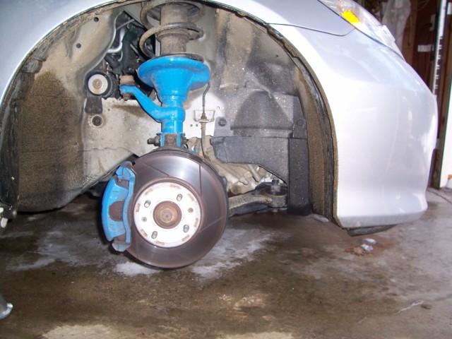

Tokico HP (blues) with stock springs
Compared to stock shocks, ride quality is stiffer (sometimes stiffer than I would like on rougher roads) but more stable(less bouncy), especially on the rear. The front and rear feels more balanced too. Ride quality over the very small speed bumps have also improved, but bigger ones remain a pain to go over. It may have raised ride height about half an inch or so. Better handling also with less body lean. Paid $336 for the set of four and $125 for install.
