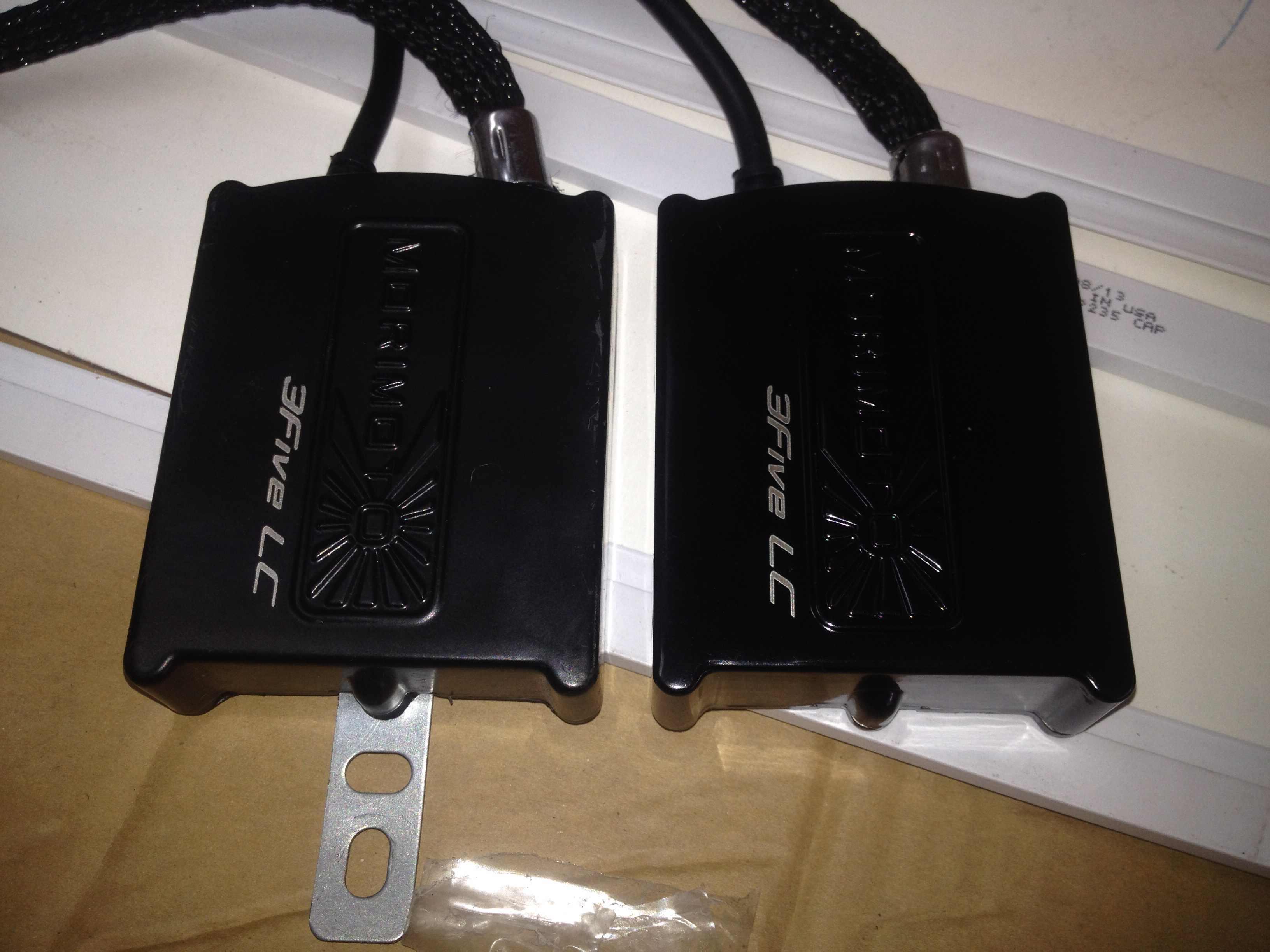

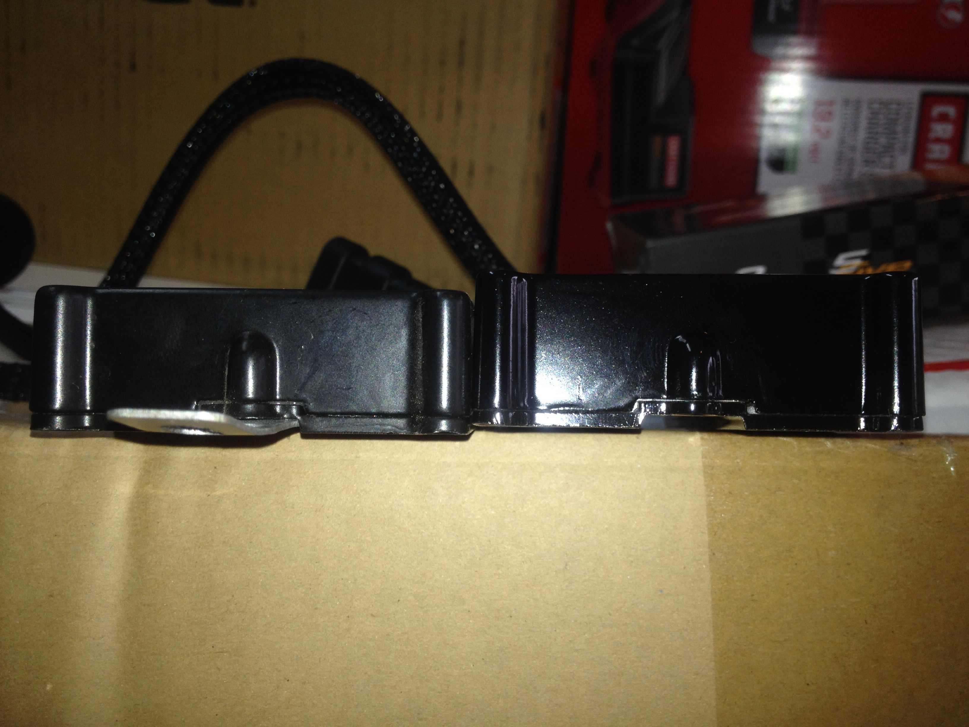

At a glance, there's not much of a difference, as far as aesthetics go. They are nearly identical, the only exception being the new ballasts being a few millimeters thicker. On the inside, there's apparently a new igniter/igniter capacitor that puts out more voltage than the old ones, as well as an upgraded chip to help it perform better. When I initially fired it up, the only thing I noticed was that the light did indeed stabilize faster. No fail-to-fire situations yet, but I've only fired 'em up twice since I installed the new ones.
