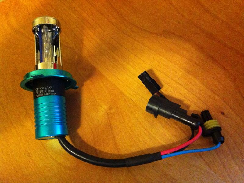

Hey guys,
Thought you might be able to help me identify this HID bulb that recently burnt out on me. I went to a few auto parts stores but no one seems to know what it is. They are not stock (2000 civic SIR) and the bulb only says "Philips" on it.

Just looks like an H4 HID bulb with a casper shield..

Re: HID Identification
Yup a plug and play bulb. Auto stores won't have that stuff. You can get them online though. Be sure to get "Hi/low" variety of H4 bulbs that have a solenoid to employ some degree of hi/low beam behavior. Don't get HID bulbs that have Halogen as the high beam.
Look for a good warranty.
