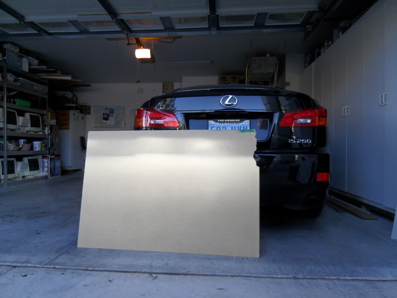

A retrofit is definitely the best way to get the most out of your headlights. I ran with HIDs in halogen projectors before, but once I got a retrofit, the difference was like day and night.
here's a side-by-side comparison pic of my before and after
top beam is the halogen projector, bottom is the HID retrofit. Both HID bulbs were being powered by identical ballasts.
