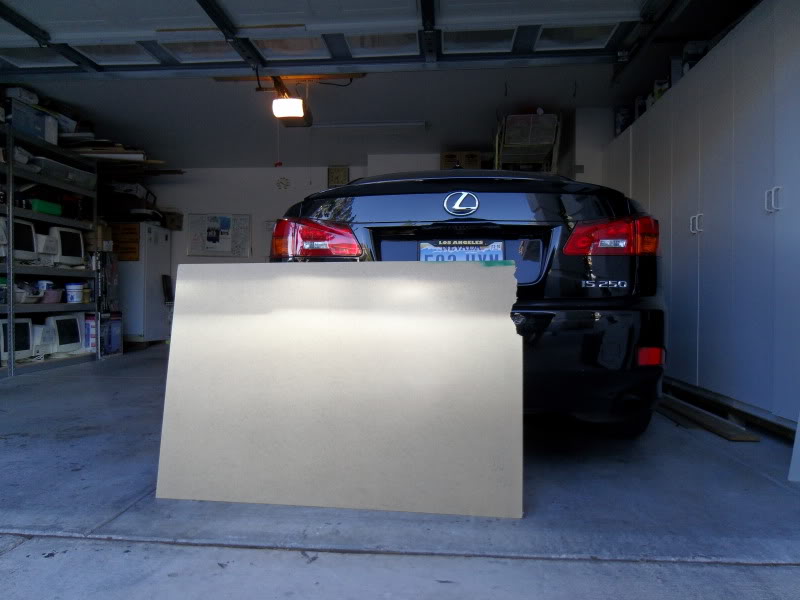

I even had a set of H1 HIDs in some H1 halogen projectors, and I modified the shield to have a clean cutoff at 25 yards. Once I switched to the retrofit, however, the difference was ridiculously apparent.
If you've looked through the "her lights" link in my sig, then you've seen this pic. If not, the top beam is the modified halogen projector. The bottom beam is a TSX HID projector. Keep in mind that the TSX projector is apparently not the best choice for HID retrofits, but I stumbled upon this retro on these forums for $200, so I couldn't pass it up.
edit: another option would be to find a "casper shield" for your bulbs, which effectively turns the bulb made for a projector into a bulb made for an HID reflector (i.e. a D2S bulb is made for a D2S HID projector, and a D2R bulb is made for a D2R HID reflector housing). People also paint the bulb a bit with some high temp paint to emulate this.
here's a thread on HIDplanet about that:http://www.hidplanet.com/forums/show...e-shields-tape
I'll let you make the judgement yourself
