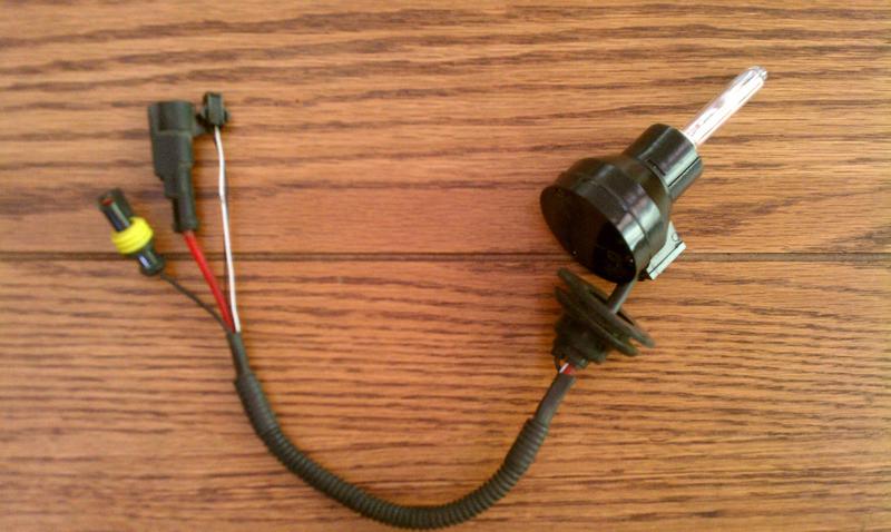

I need help finding a proper replacement bulb and/or wire harness for an aftermarket HID kit installed into my 2001 civic by the previous owner. The system say it's a DDM 35watt 12 volt hi/low. It has a 3 plug wire harness (see attached photo) and I think it is 6000k (crystal white). When I go to the DDM site they don't have anything that looks similar with 3 plugs. Any suggestions that will work with my system would be appreciated.

looks like an H4 lo/hi style bulb with a solenoid to move the bulb so you can have hi beams. thats what the small white wire connection is for. its not required, you could just get a regular H4 hid bulb and it will plug to the red and black wire connections and work as lo beam only.
