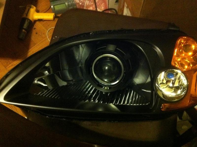

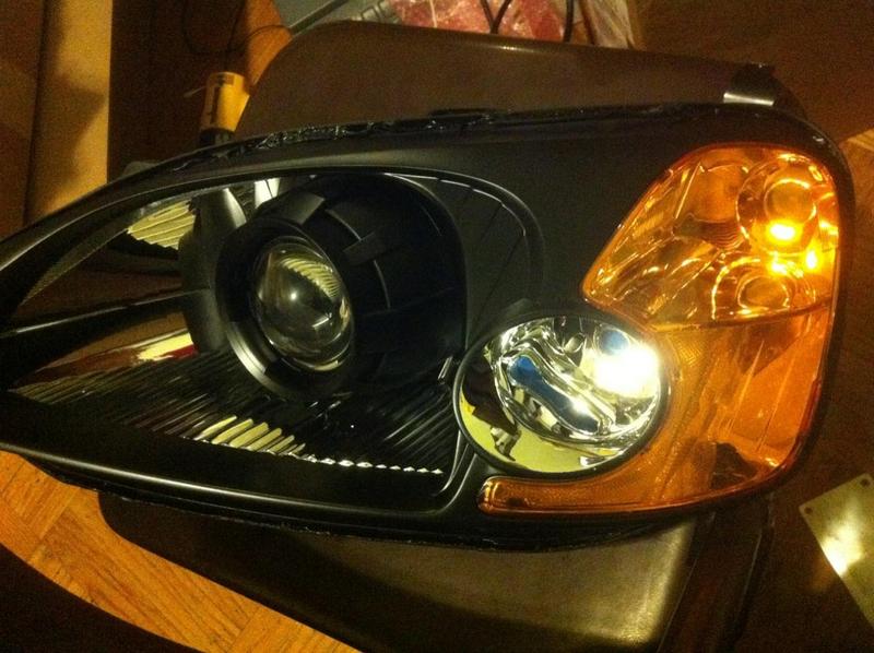

Rich sent me a couple of in-progress pics of the new retrofits.
FX-35 Projectors
Black Minigun Shrouds
Denso Ballasts
Color Mod Lenses
Can't wait to intall!

Love it. Look very beautiful. But hopefully that is not a blue drl or parking light whatever it called but looks awesome.
Thanks! Nah, that's just blue tape covering up the parking light hole.

That looks freaking SICK! Didn't think black shrouds in a chrome reflector would look that nice!
Are those black ebay headlights? Or painted OEMs? if theyre the ebay ones the I've got the same ones and am retrofitting Minis in them now Just finished laying down the LED strips on them. Wanted to add a personnel touch
Probably clean everything and will seal them back up tomorrow. Build my wiring harness and install/aim on the weekend!
Thanks, bro. I was worried about how they would turn out too. Came out better than expected. They're painted OEMs. I did my first ones. Never again. Glad to sit back and have someone else do the work, this time.
Good job on your retros. Make sure you post up some pics. I feel ya on personalization. Everything for 7th gens has been there, done that. Haha.
