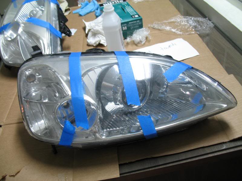

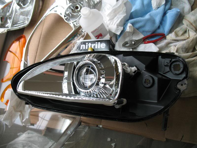

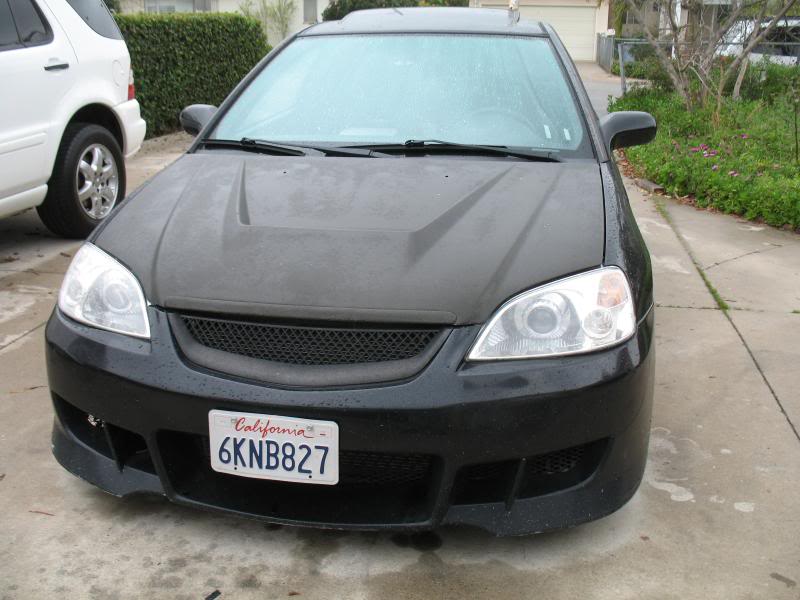

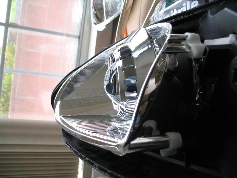

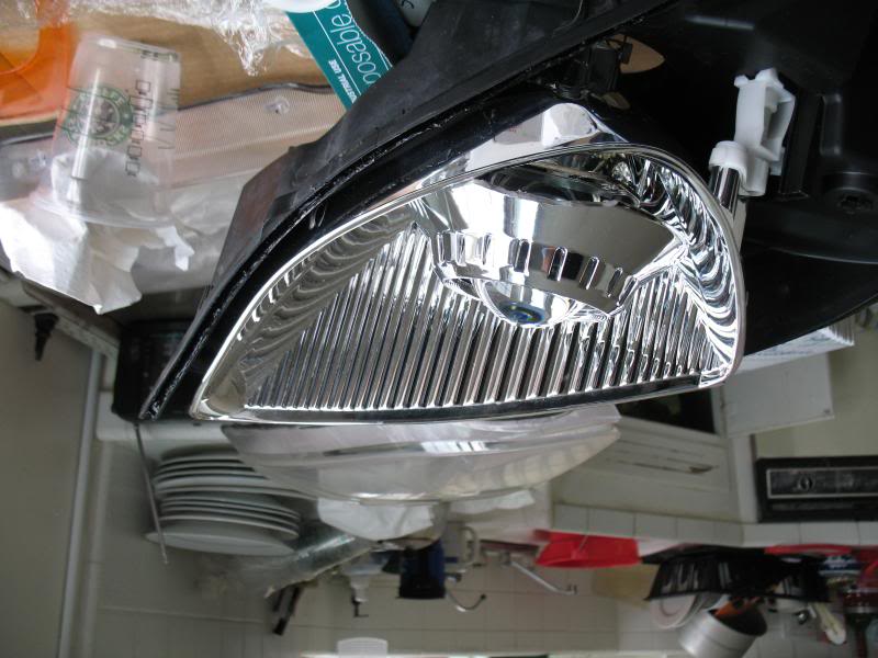

those aftermarket headlights are fine. since ur current headlights are fogged, you might as well get new ones.
as for mm projectors, they are decent. i would get no higher than 6k. it defeats the purpose of having a retrofit.
as for shroud, i have E46r. looks best imo.

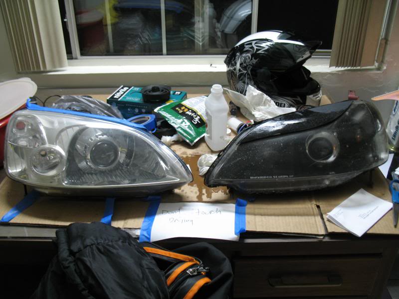

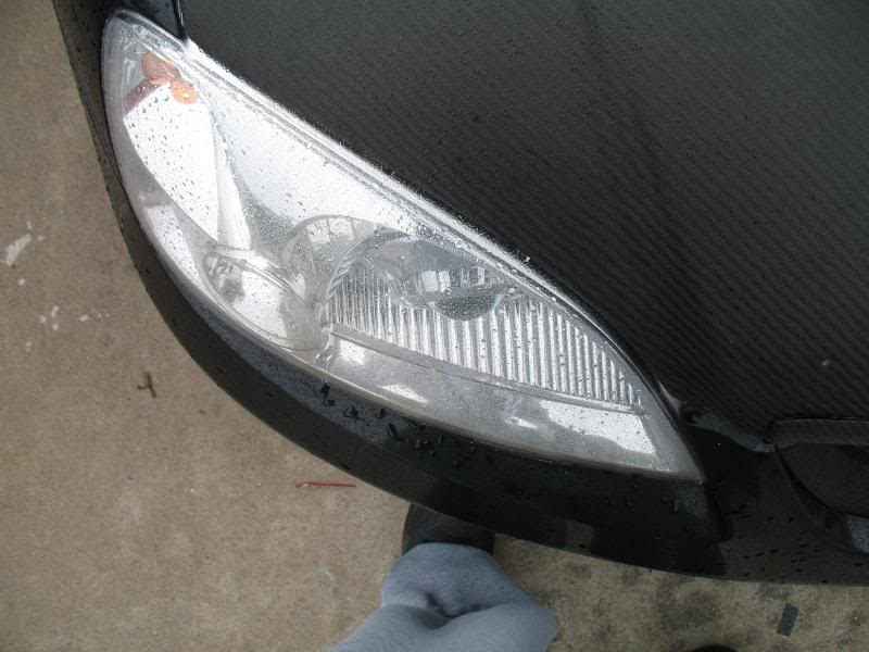

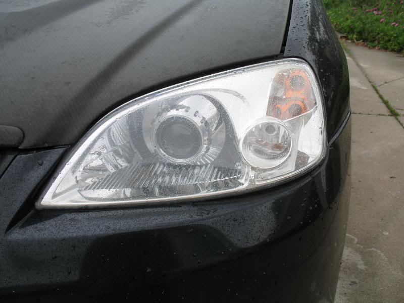

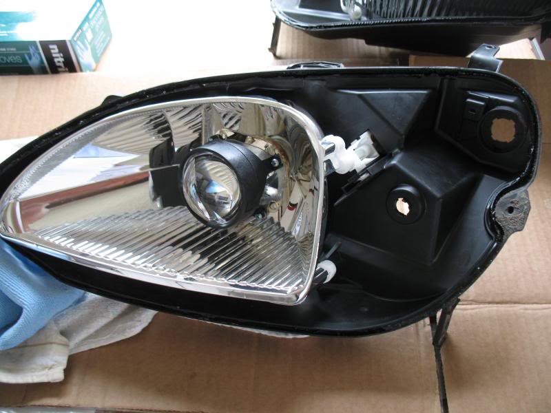

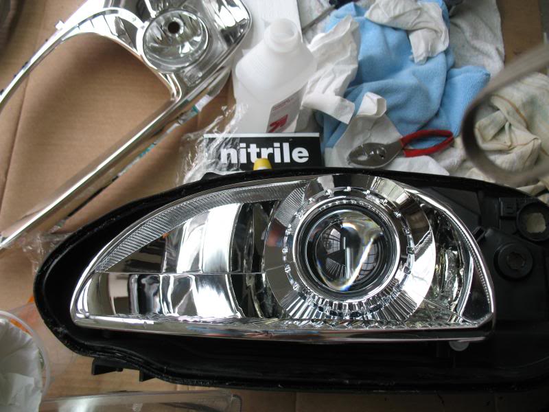

more pixs.......just for ***** n giggles.
new retrofit (left) ..... old retrofit (right)
