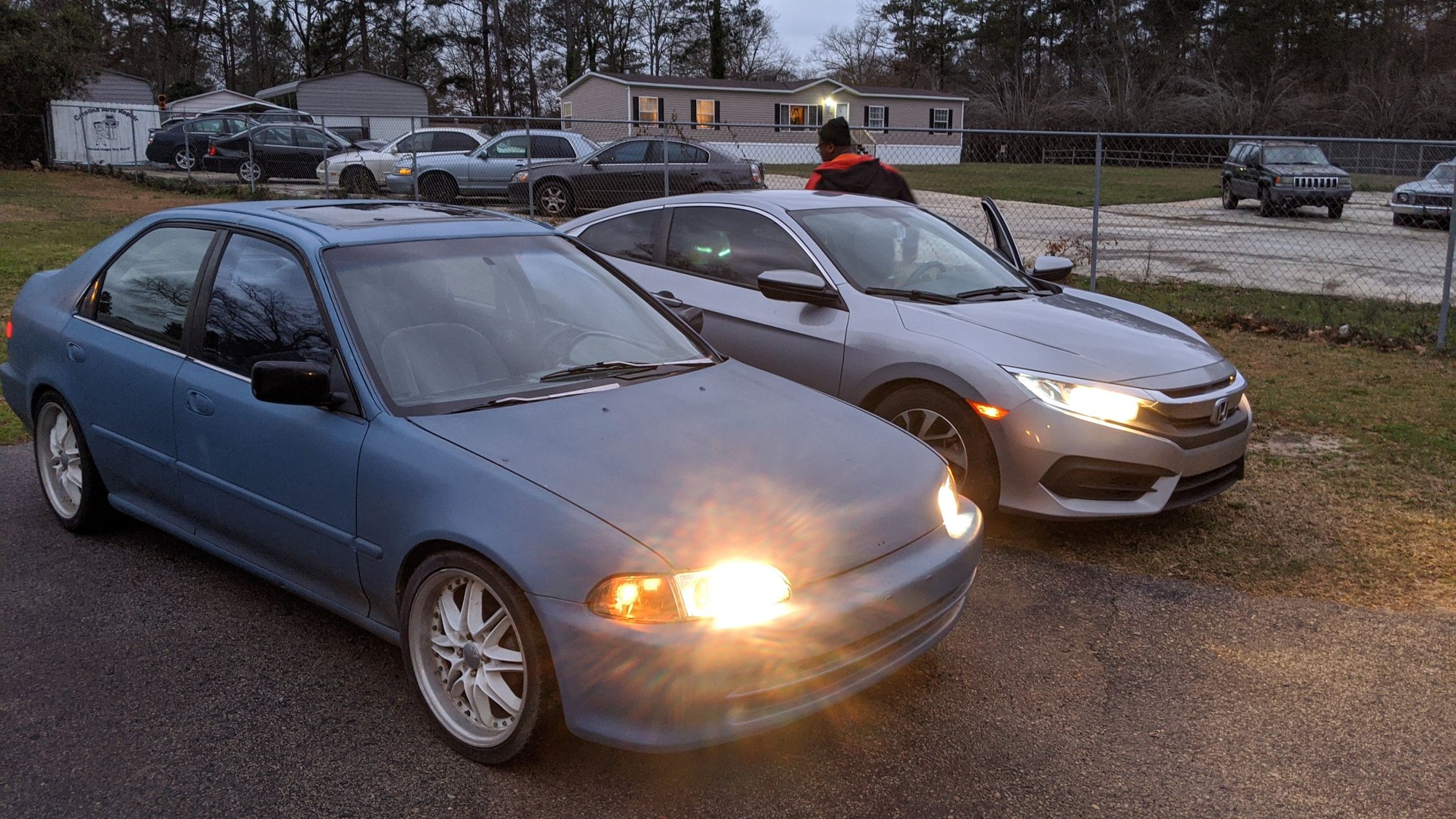

Alright here is another new car guy post just picked me up a 1992 Honda Civic I got to get the vid don't know what trim it is but it has a d15b it and should I k swap and which k or what engine should I put in it or build the d15
My car is on the left

yeah, that be awesome if you send me a link actually looked around the engine today and found a lot of problems I didn't want to see. a bunch of broken bolts in the engine, cut wires and such all crap the previous owner did.
edit: also any paint ideas the blue on it is a non-glossy pearlescent pain and its bad so I want to paint it

I've always loved championship white on 5th gen civics. That paired with some black RPF1's would look great.
