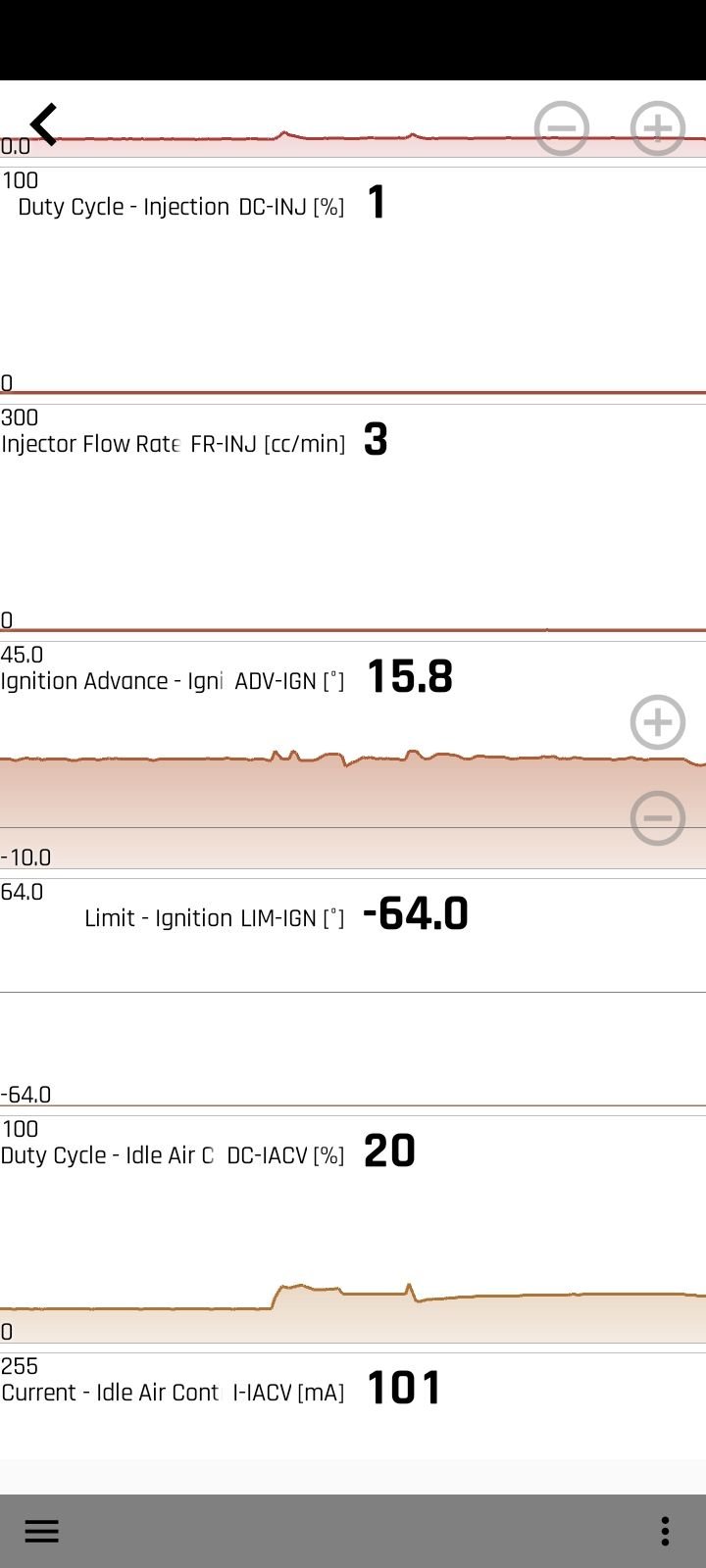

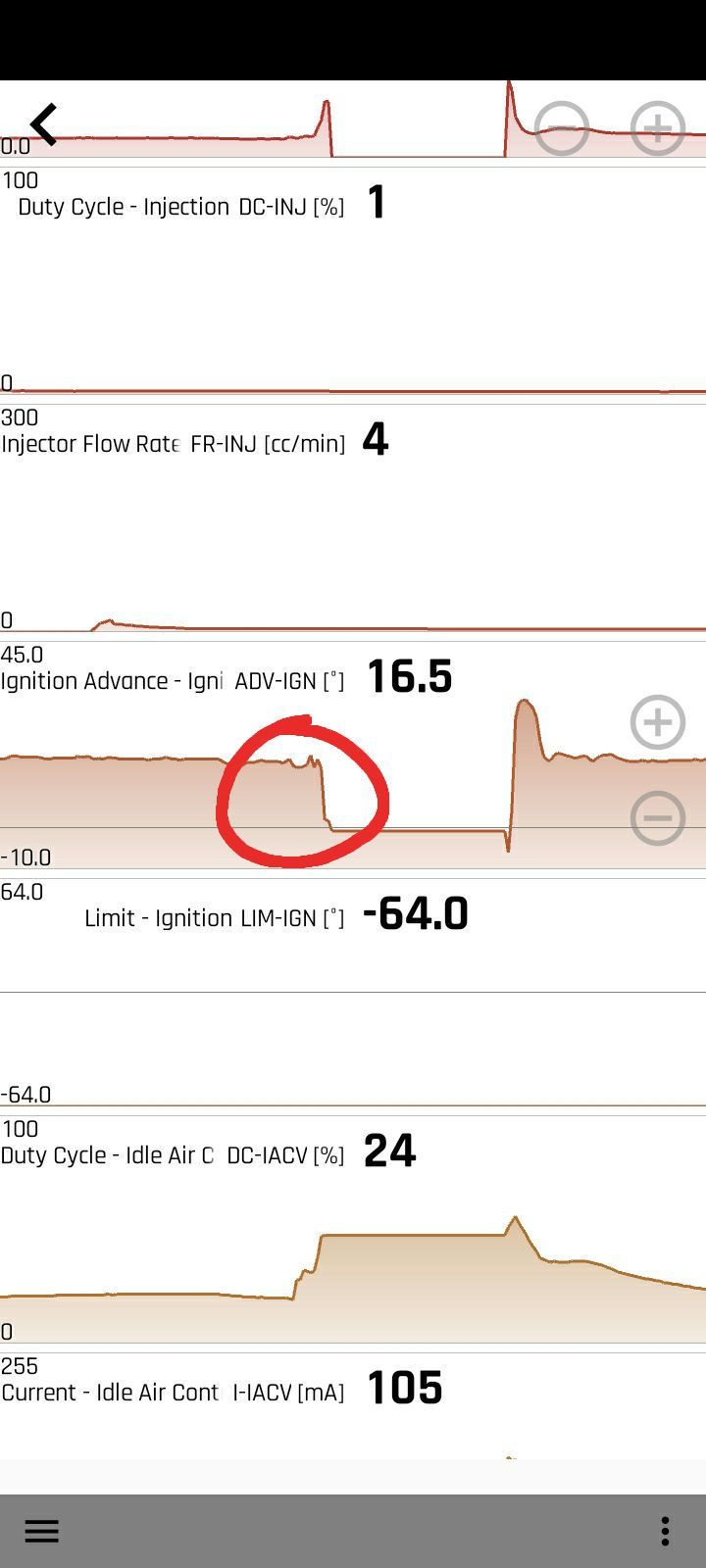

just uploaded two images from the OBD on ignition advance. the red circle is where the car starts to stall.
