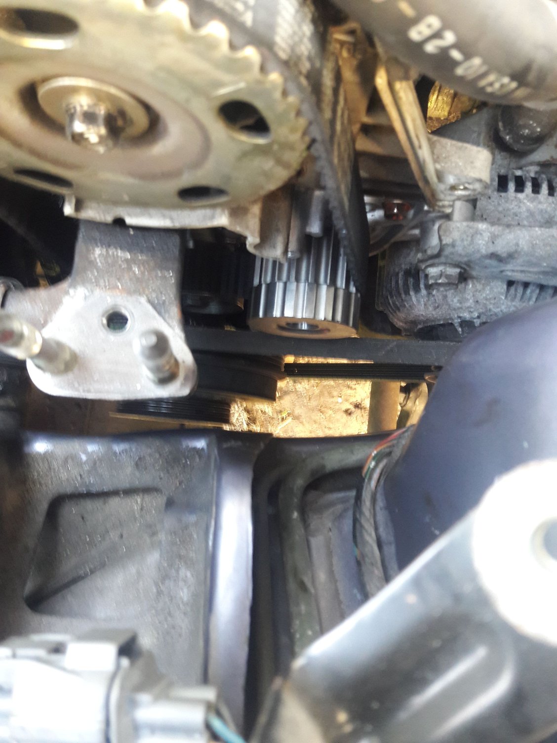

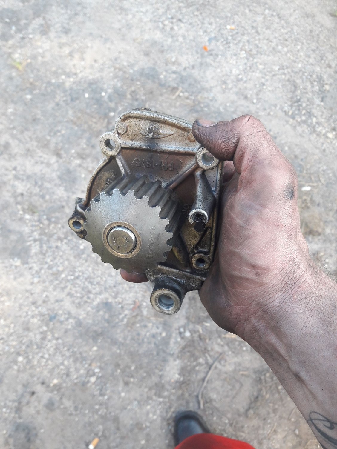

sorry about pic size if they are too big. Does this mean that's not the right Water pump? It bolts on. Lower timing cover will not fit over it. I've not started it still putting it back together. Belt seems a little loose but rotated it with a ratchet and checked marks and they all line up still. Just wondering if I should remove it all and take the pump back or if its ok. Thanks in advance. First time doing this kind of work.

Does not match original pump: Wrong pump.
Remove and return to store and get correct pump. Take original pump with you to make sure the next new pump is correct.
If parts pimp insists it's right because that's what the computer says, that still doesn't make it a correct part.
