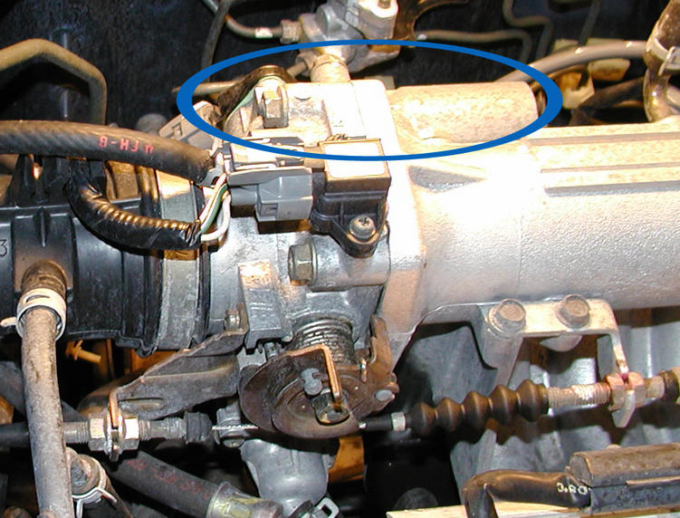

One thing you might want to check out is your IACV (Idle Air Control Valve) on your air intake. If that gets gunked up and doesn't work properly, that can cause your engine to have that idling issue. Next time you have the car running and the hood up, try closing back completely on the throttle valve, and if your engine starts to sputter out, then take it apart and spray some brake or carb cleaner on it, and see if that solves your issue.

I had this same issue with my 98 EX Try what J-master said. here is what i did
Crank up the car, pop the hood pull off your intake and look inside above the IACV. there should be an open spot there, if so just cover it up with your fingers and see if the idle issue stops, if that is the problem you can just buy the new part, which for me was $312 or just bypass it by covering it with something.
I just cut a peace of hose and put it over the hole the vacume will pull the hose down snug then make sure u sucure it with something. i just epoxy it to the intake lol. $3 fix and seems to have knocked off my issue

It may be that your fast idle valve is faulty or not getting coolant to it. I've seen a few older cars that clogged the steel coolant tubes that lead to the valve. This keeps the valve from warming and it leaks unwanted air into the intake. There are 2 coolant hoses attached to the valve, check them when the car starts to warm up and see if they are warm. Usually the tubes that clog are attached to the breather tube that goes to the back of the valve cover.

I had the problem on my 94 after cleaning my IACV. I ended up having to replace it with one off of ebay. Worked fine after that. But I would try cleaning it first. It's attached to the back side of the throttle body.
