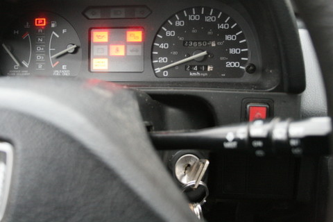

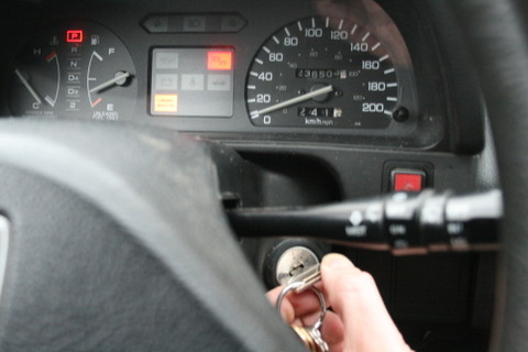

Well it usually started, now it wont start at all.
I don't have money to get another ignition switch, I'm going to have to bypass it.
Its not closing the whatever circuit makes the yellow engine light go out.
