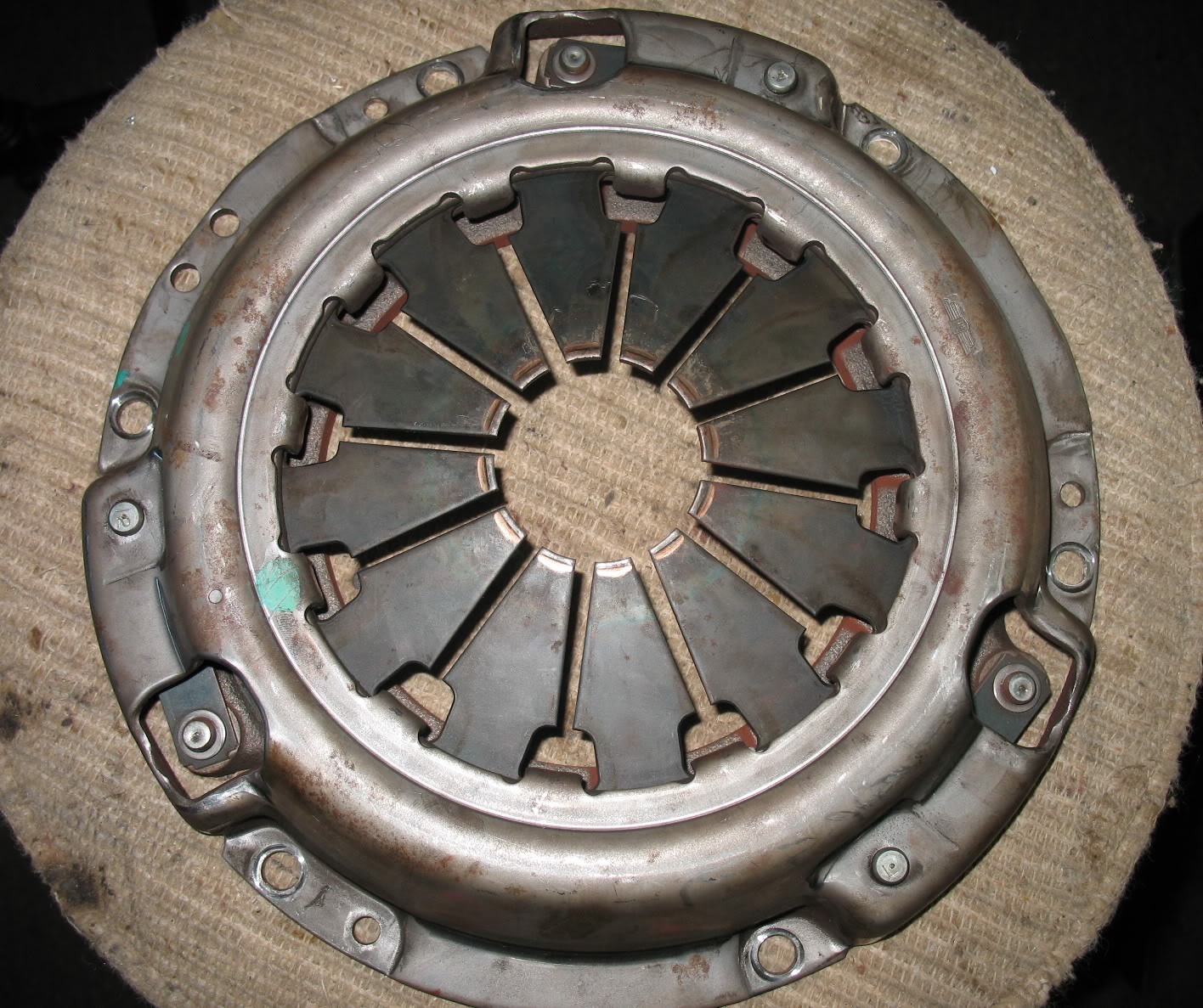

Here are some pictures of the clutch disc and cover. Note how some of the gouges on the disc have bits of brass or copper etched in them - a clue perhaps?
Also, do you think the fingers should be worn that much for something with such little use?

Metal in the disc, normal, woven fiber disc.
I don't see anything wrong yet.
Show the face of the pressure plate and the flywheel.
Are all the "fingers" in the center level?
If the pressure plate and disc were bolted back on the flywheel, would the fingers still be level?
Maybe a pressure plate problem, like the diaphragm spring cracked and broke or the pivot broke, it could allow half of the ring to engage even though the pedal was down. You would still have some feel in the pedal too.
I'm SWAGing now. I got nuthin.
Edit: I wonder if you have a cable problem that isn't obvious from the outside.
