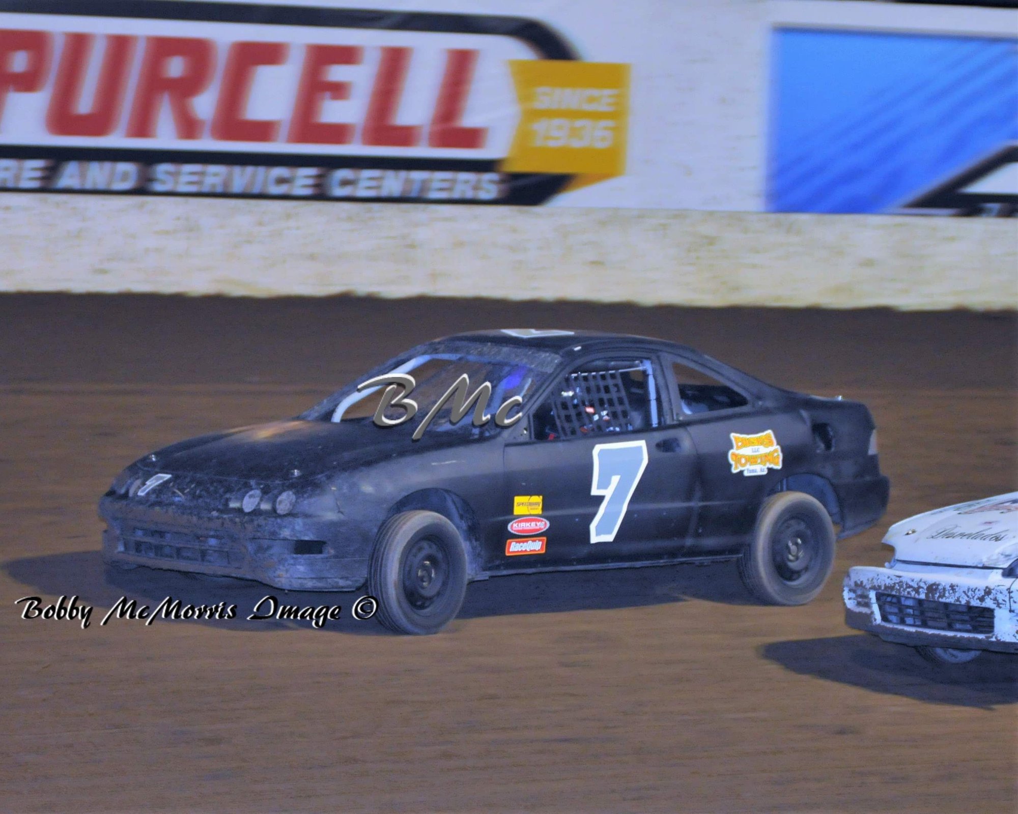

I have a 92 honda civic with a B18b swap in it (dohc, non-vtech) from a 95 Integra

Anyway, I am one of the fastest cars in the field, but I have one major problem. I can run for several laps and be the fastest car out there, and after a handful of laps, my car suddenly looses power. I've had several people tell me that it is going into "limp mode".
What happens is, suddenly the engine goes to idle while I'm racing. I'll be at full throttle accelerating down the strait, then it goes to idle. It'll sit there for a second or two, then rev up, then go back to idle, rev up, idle, rev, idle, all the while my foot is to the floor board. It'll do that several times well over a lap, almost two full laps (20-30 seconds), then it'll be fine for several laps. Then, it'll do it again. In a 35 lap main, It'll happen 2-3 times. I'll go from a 15.39 second lap, to a 20 second lap instantly. Then, I'm back to a 15 second lap.
